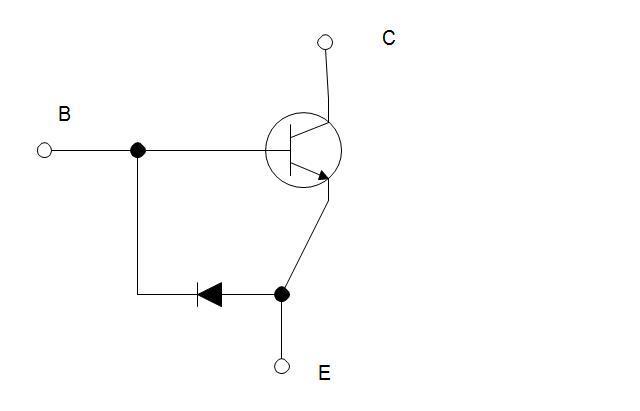

The base-emitter voltage, V_be, typically never exceeds .6V. Because of this low value, the base-emitter junction must be protected against too high a reverse voltage. A diode is usually used to protect the junction as shown in the figure for a npn transistor.
a. Explain the function of the diode and the conditions under which protection is given.
b. Draw the equivalent circuit for a pnp transistor.
Sorry about the drawing. I am having trouble drawing straight lines with the circuit drawing software I am currently using.

If there were a reverse voltage applied to the circuit, would the diode need to be there in order to prevent the forward bias diode in the transistor from breaking down?
The more I think about it, the more it seems obvious. The diode prevents the forward bias diode in the p-n junction (emitter base junction) from taking damage. Protection is given as soon as the reverse voltage is greater than the voltage drop of the added diode (.6V). If that is true, then of course the pnp transistor will have the same properties. The difference being that the added diode would be reflected across base lead axis.
