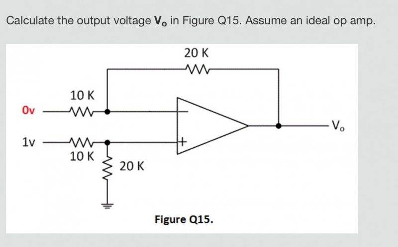

Hi there, these aren't homework questions. I came across them during revision and couldn't solve them. So any help would be appreciated. The ans for the 1st image is 2 and second image is 3.
For the first image, I attempted to calculate the Req for 10k and 20k resistors connected to V1 since they are parallel. And then to get Vo, I took (1+R2/R1)(V1) but I got (1+2)(1)=3 instead. Where have I gone wrong?

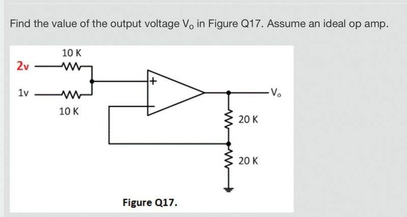

For the second image, i tried using superposition principle by killing 2V to get Voutput due to 1V then killing 1V to get Voutput due to 2V. I got Vo(due to 1V)=(1+20/20)(1)= 2 and Vo(due to 2V)=(1+20/20)(2)= 4 so adding them would be 6V but the answer is 3V.Where have I gone wrong?

First Figure: For which purpose do you need Req?
There is a simple voltage divider at the non-inv. input (20/30=2/3) - connected to an amplifier with the gain(1+2)=3.
Hence, the overall gain is (2/3)*(3)=2.
Second figure: With superposition (same principle with voltage division) we have
2V*(1/2)*(1+1)=2V and 1V*(1/2)*(1+1)=1V.
Hence, Vo=3V.

The way that always works for opamps is this
Write KVL for voltage at opamp's + input.
Write KVL for voltage at opamp's - input.
Set them equal, solve for Vo.
1st image:
Vat +input = 2/3 , do you see why ?
Vat - input = Vo/3 , do you see why ?
equate them, 2/3 = Vo/3 ,
multiply both sides by common denominator of 3 and you get 2= Vo, swap sides to get Vo=2 .
It's that easy .
2nd image
Vat +input = 1.5 , do you see why ?
Vat - input = Vo/2 , do you see why ?
equate them, 1.5 = Vo/2
multiply both sides by 2 and you get 3= Vo, swap sides to get Vo=3 .
The KVL equations for V at + and - inputs are seldom so convenient as in the examples you gave,
but that method always works and you ought to practice until it becomes intuitive.
