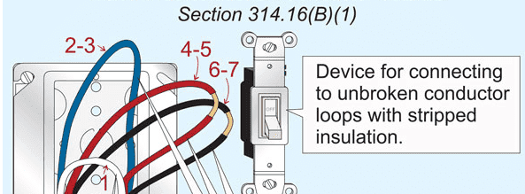

from that great link -
How to get same effect as two wires under one screw
strip insulation and bend the wire around the screw.
just got to think before you cut.
