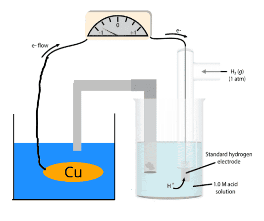

Let us solve it for Cu at pH =8. I found this Pourbaix diagram. What is the electrochemical potential I should use to check that Cu is there the stabel form. Should I check for all values of E between the blue lines at pH = 8? How can I measure the E value in reality?
In the case of pH 8, your task is pretty easy. But in general, the Pourbaix diagram will give you the potentials/pH’s over which different forms of a metal are stable in water (usually).
As for what the potential is in an experimental situation, it’s either chosen by you when you apply a voltage or it can be measured straightforwardly by a potentiometer.
If I am right, I can connect the copper to a SHE, measure the voltage and that is the E I have to use in the Pourbaix diagram. As the E is not specified in the original question, I can not give a unique answer.

In fact it is not an assignment I have to submit, but I think the policy is that I put this kind of questions here. I am even not a student in chemistry, I just try to understand it. The solution of the exercice is clear. You look up the pH, you draw a vertical line. You see for which E the metal is stable. The E can be measured with an SHE connected via a salt bridge with the water around the metal.
