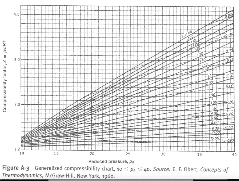

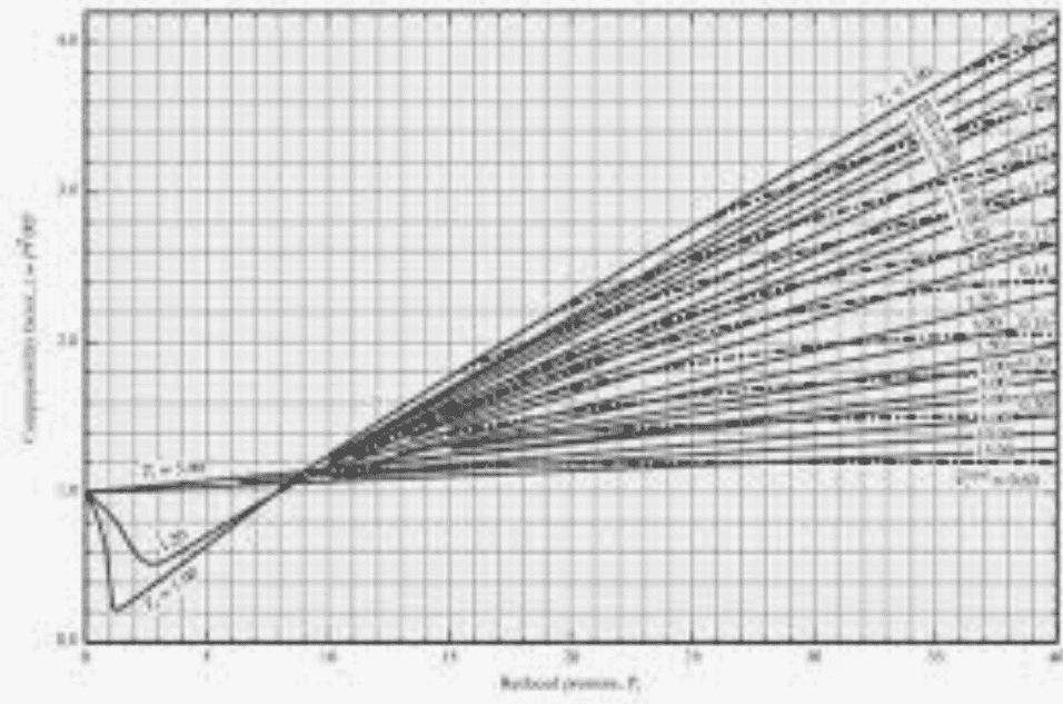

Thank you all for your replies.
So, how about an accurate equation for "weakly-interacting gases" (such as N2) at T ~ room temperature (293.15 K) and for relatively high pressures (~150 to 500 bar)?
As I wrote above, I'm working with high pressure dynamic vessels (think piston compression). This is experimental result: initial pressure 200 bar, volume is compressed to half its initial value, measured final pressure is about 500 bar (= ideal gas result of 400 bar x 1.25). Van der Waals predict final pressure of 720 bar (= ideal gas result x 1.8). Gas is nitrogen N2.
Is it better to use compressibility factor charts for room temperature and 150-500 bar pressure ranges?
Thanks a lot.
What value of z do the z-factor charts give?
I have to check. I just found some Z charts on the internet, but no source Excel data sheets whatsoever, in order to rebuild the chart myself. Maybe you know where to find them? Thanks.

I confirm your results using the vdw equation, I’ve also tried the z-factor method, based on plots on the literature at higher reduced pressures (the 500 bar case is Pr of 14.5), and the z-factor at the case of compressed volume was only about 1.3, consistent with the 500 bar pressure. So the compressibility factor plots are more accurate.
Thanks so much for taking your time to check the data. Could you please suggest a reliable compressibility factor plot (for nitrogen)? Thanks again!
Google for it at high pressures (at least up to reduced pressures of 15). Google “generalized compressibility factor plots.”

My comment was that the Z factor analysis is more accurate than the VDW equation for the range of values that interests you.
What value of the volume and z-factor did your article predict at 293K and 200 bars, and what value of pressure did it predict when the volume was reduced by a factor of 2?

Just rebuilt the Z-factor graph in Excel. I'll throw in some values and let you know.
Well, it wasn't as easy as I thought. Maybe you can help, thanks.
Known parameters are:
  • initial volume (real) = 1 L
  • initial pressure (real) = 200 bar
  • final volume (real) = 0,5 L
Goal is to find final pressure (bar).
As said, I rebuilt the Z-factor v. Pressure chart in Excel using equation 14 in the article. Seems to work great!
Problem is that any Z-factor formula or chart needs you to know the pressure and gives you the "correction factor" (Z-factor) for the volume, whereas I'd like to have the opposite.
What I did in Excel was:
  • column A = pressure (bar) [starting from 50 bar and up to 600 bar, with 0.1 bar increments]
  • column B = Z-factor formula (from equation 14 in the article)
  • calculating n (number of moles) from Pinitial and Vinitial (known values) and from Zinitial (easily calculated plugging Pinitial in Z-factor equation)
  • column C (starting from the row corresponding to Pinitial = 200 bar): I plugged in the formula to calculate the Volume (i.e. V = (Z*n*R*T)/P ) for all following rows up to (actually, down to - if we talk Excel-wise!) 600 bar, for each of the in-between 0.1 bar increments)
  • finally, I searched column C for the value of V closest to 0,5 L and looked at the corresponding pressure in column A
Is this the only way to "calculate" final pressure knowing the final volume? Or am I missing something trivial here? Is there an explicit formula for Pfinal? If I write down the EOSs, I always end up with two variables (Pfinal and Zfinal) and can't solve them.
By the way, with the method described above, I got a final pressure Pfinal = 547.7 bar (for a corresponding Z-factor of 1.401).
For nitrogen, 547.7 bar is around 16.15*Pcritical, so it's just out of the "super-accuracy range" (the extended chart, up to 600 bar, seems nice and smooth though).
Sorry for the long post! Thanks for your patience.
