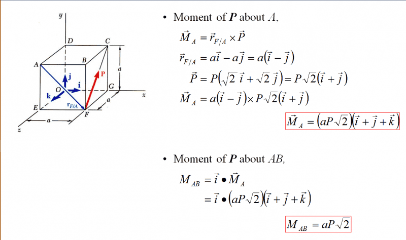

I can't understand why the vector MA finally become (i+j+k) ?? is it beacuse of (i-j ) becomes k ??
  • Cube with corners labelled A to G, axes x, y, z, unit vectors i, j, k and force P on edge FC; beside it, the moment of P about A and about AB written out in vector form.

That's wrong!
[itex] (i-j)\times (i+j)=\underbrace{i\times i}_0+i \times j- j\times i-\underbrace{ j \times j}_0=i\times j+i\times j=2 i \times j=2 k[/itex]
Shyan said:
That's wrong!
It's wrong before that, even.
##\vec P = P(\vec j -\vec k)/\sqrt 2##
Alternatively, by calculating the distance from A to the line of P the moment is seen to have magnitude ##aP\sqrt {\frac 32}##. I believe the correct answer is exactly half that shown.
-j X i=k
That k and the other normal one from i x j=k, add up to 2k.
