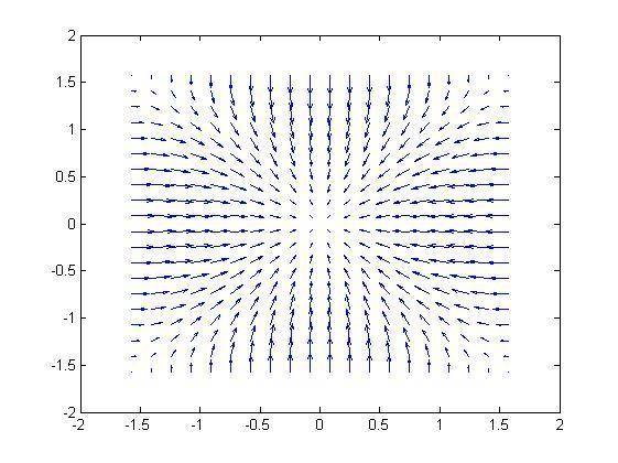

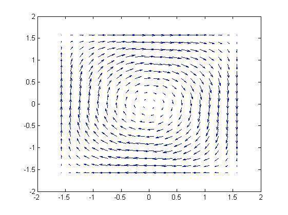

A velocity field is given by v = ui + vj
where:
u = cos(x)sin(y)
v = -sin(x)cos(y)
x = y = [-pi/2,pi/2]
the stream function psi is:
psi = cos(x)cos(y)
Matlab function:
function[X,Y,psi] = streamfun(n)
if nargin < 1;
n=20;
end
x=linspace(-0.5*pi,0.5*pi,n);
[X,Y] = meshgrid(x,x);
psi=cos(X).*cos(Y);
calculate the velocity numerically with \nablapsi
I am starting with the assumption, the velocity is \nablapsi, is this correct?
[x,y,psi] = streamfun(20)
[u,v] = gratient(20)
quiver(x,y,u,v)
and I get numfield.jpg, see attachment, but this is not the same as my velocityfield.jpg
which I got from:
x = linspace(-0.5*pi,0.5*pi,n);
[x,y] = meshgrid(x,x);
u = cos(x).*sin(y);
v = -sin(x).*cos(y);
quiver(x,y,u,v)
Can someone please help me and tell me what I am doing wronge.

nabla*psi = -sin(x)cos(y)i - cos(x)*sin(y)j
