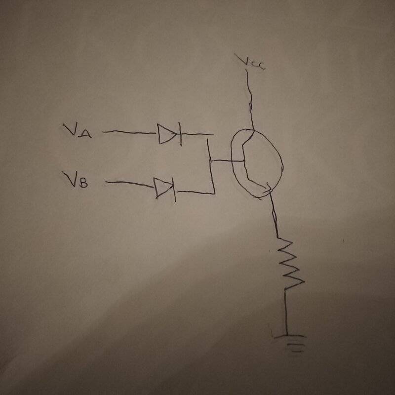

I have created a voltage adder using this circuit where Va and Vb are the input voltages.
And Vout is between the emitter and the resistor. How can I modify it to a voltage substractor?

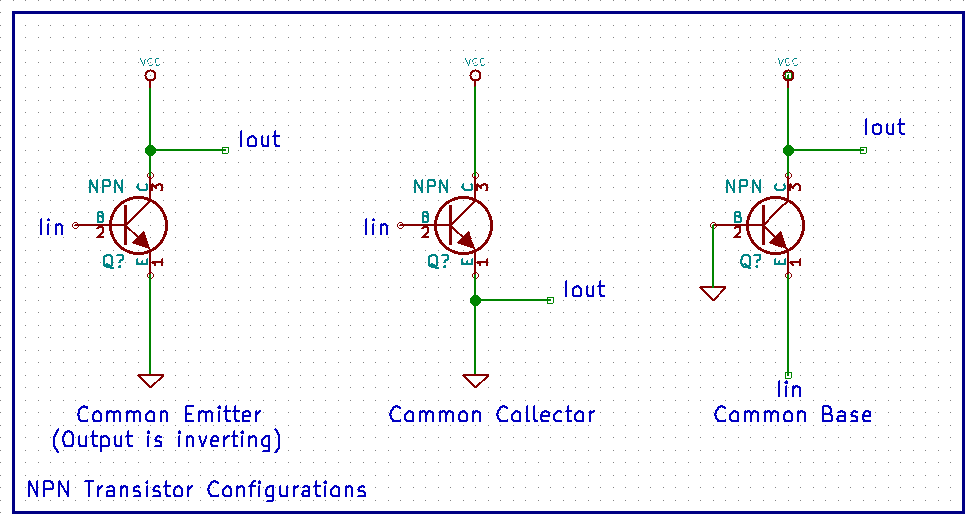

You show an Emitter Follower configuration there, and yes the voltage gain is positive (and close to 1) through it.
Have you looked the "Common Emitter" configuration with an NPN transistor yet? The gain through that circuit is negative. Have a look at CE circuits, and learn how to set the voltage gain close to negative 1.

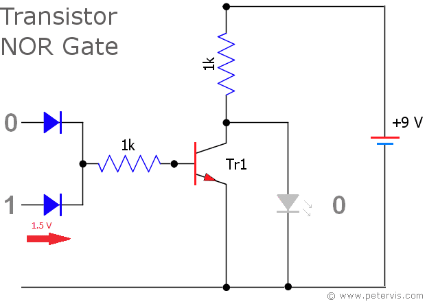

What you have drawn is a primitive "OR" gate (if one input is "high", the output is "high". Here is a schematic of a "NOR" gate (common emitter instead of common collector).

CE amps are inverting (voltage gain is negative), and Emitter Follower amps are non-inverting. If you really want to build a subtractor, you need at least one part of that circuit to be inverting, no? And the other part to be ________ :smile:

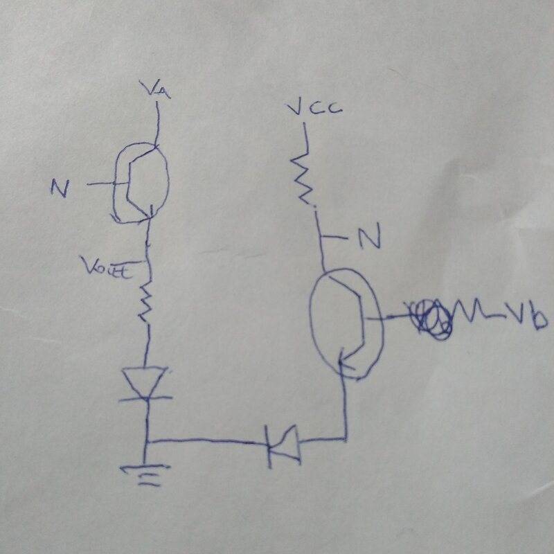

Will this work?
berkeman said:
How so?
What you have drawn is an inverter not a common collector amplifier.

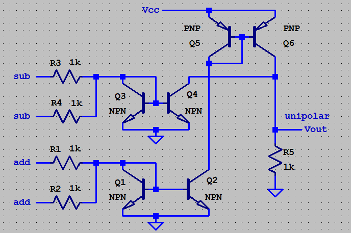

Voltages can be converted to currents by resistors.
Current Mirrors use pairs of common emitter transistors to add and subtract currents.
Would you consider using current mirrors to make the voltage arithmetic circuit.
https://en.wikipedia.org/wiki/Current_mirror#Circuit_realizations_of_current_mirrors
If you can define the arithmetic problem, I can design a mirror.

The current that flows through Q1 will mirror through Q2, because their base and emitter voltages are the same.
The current that flows through Q3 will mirror through Q4.
The current that flows through Q5 will mirror through Q6.
Q1 is the total summing currents. Q1, Q2, Q5, Q6 are all equal.
Q3 is the total subtracting currents. Q3 and Q4 are equal.
The Q4 current is removed from the collector of Q6 before the remainder flows through R5.
The output voltage is developed across R5.
Do you have a specific question?

I want to substract voltages.
If you put voltage X on a sum input and voltage Y on a sub input,
then the output voltage will be X - Y.

  1. If you want an addition circuit, remove the diodes (they turn the analog circuit into a digital)
  2. If you want to subtract, invert the signal you want to subtract and then add (a standard common-emitter circuit will invert the signal). Figure out:
    1. How to ensure that the gain of the inverter is 1.0
    2. How to ensure that the DC level of the inverted signal is the same as the non-inverted.

If I remove the diodes current may flow from 1 input to a second input and I don't want that.And I have posted another circuit which makes the subtraction.

The circuit you originally proposed will not work as you hope.
The base current will be provided almost entirely by the higher input voltage source and the output voltage will be that voltage (minus a diode drop). As @Svein has pointed out it will act as a weird OR gate.

Unless I am horribly wrong - no. The output of your circuit will be that defined by the higher of the two voltages VA and VB.
