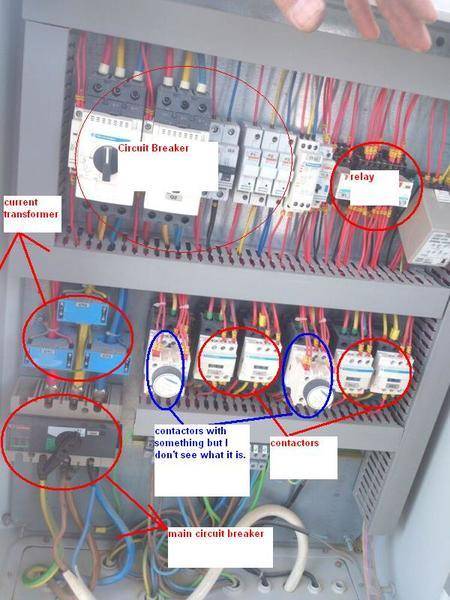

hey ... i am working on Electric control panel for pump
but the Problem i am new on this Field
all i know in this Electric control panel is conductor
please can you help me to find References explain Components of Electric control panel
or just anyone tell me the names of Components
http://im24.gulfup.com/olfU1.jpg

considering that you have confessed to not knowing anything about this panel, you shouldn't even be playing with it without qualified supervision !
If you haven't already started an electrical trade, then you should be.
Working with mains voltages and a panel this complex requires that you have suitable qualifications, not only for your safety but the safety of those making use of its functions
As a result it would be unwise for anyone here to give you just enough info to risk personal injury or property damage

hey davenn
all i need is know the name of Components to learn more about them
that's it>>>>
Google circuit breaker, contactors + auxiliary contacts, relay, main circuit breaker, current transformer.
thats all I recognizes form your pic.
do you mean :
1- contactors
2- circuit breaker
3- auxiliary contacts
4- current transformer
5- relay
am i right ?
http://im18.gulfup.com/Ik1A1.jpg
See the imagine

thanks dude ... you are the best
1 - Motor rated Overload trips
2 - Miniture circuit breakers (mcb's)
3 - Cartridge fuse holders
4 - Contactors
5 - Auxillary timer unit (Clipped onto a contactor)
6 - Current transformers
7 - Plug in relays and bases
8 - Dinrail mount terminals
Ps who ever connected this up is a bit of a bodgit IMHO as they used an Earth coded cable as a phase wire and 2 generations of colour coding is present within the same unit (incoming blue is on a new colour code cable and represents neutral where-as the panel is wired old colour code hence blue is phase colour), really poor workmanship, as well as derated cable size tapped onto incoming live terminals without fusing down, another worry is where its incoming earthing although may be connected outside of visual field seems to be missing?
Good catches, darkwood!

Is this part of a "hands-on" school course?

If his answer to the above is in the affirmative, that would explain a lot. :smile:
dlgoff . the thing is i am Student of food process engineering
but my University force me to work on that Electronic Control Panel
i told them i have nothing to do with it .. they told me you are not Graduate until done this work
anyway thanks you all for help me
I said it at the start
and I will say it again
This is a great way for some untrained person to get electrocuted and may also others using equip powered by this panel
because some one who doesn't know what they are doing has played with the panell!
