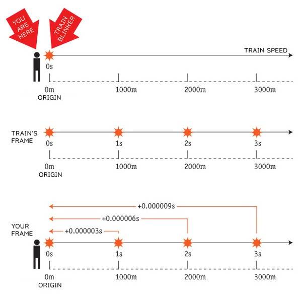

Perhaps you know the kind of metro trains and airport shuttle trains with glass doors on the train and facing glass doors on the platform. Put the platform doors dangerously close to the tracks, so that they risk touching the train doors when the train passes by. Stick a high tech, high power solid state laser against the bottom of the glass door in the train, aiming straight upwards.
Turn the train into a riding cloud chamber. And stick a huge photographic plate, which we will call plate S, against the glass doors of the platform.
You may also place another photographic plate - let's call it S' - in the train, pushing it against the laser, with the laser in the middle; however I think that there are no issues about that one.
Now speed the train at an impossibly high speed past the platform, giving off a nanosecond light pulse at the exact moment that the laser is next to the middle of the plate S. That point we give the plate coordinates x=0, y=0 for S, and x'=0, y'=0 for S'.
Note: at this point we don't care about any length units; merely a qualitative description will do, in order not to get distracted by non-issues at this point of discussion.
You imply that the horizontal position of the light scattering water molecules at different heights wrt the photographic plate S on the platform is x=0 at any height y. That is exactly what I disproved in my post #14, and which you did not really answer, probably because you did not understand it. I'm confident that now, with the more concrete example of the pulse laser in the train, it cannot be misunderstood. And as it's a few pages back, I'll copy it back here:
Take a light ray going straight up from bottom to top, as depicted on the left, but in a cloud chamber with glass walls, and to which we attach the label S'; necessarily scattered light from halfway up (at Y=0.5L) is also at the same horizontal position in S'.*
However, what if this cloud chamber S' is moving at very high speed to the right as observed by a stationary system S, as depicted in the sketch on the right?
The scattering water molecules at the bottom in S' will be detected at for example x=0 in system S.
However, while the light moves up in S', S' moves to the right. Necessarily the scattering water molecules at 0.5L in S' are not at x=0 in S, but are slightly more to the right. And the scattered light at the top is even more to the right.
IOW, by geometric necessity this is what must be measured in S.
However, according to your answer, the water molecules that scatter must be at rest relative to both plates! But that is not possible, for that corresponds to zero train speed. :rolleyes:
If we make the train high enough then the laser light can already be past the platform but still be leaving a trace on the photographic plate on the platform, following your analysis. :devil:
Thus, once more: please explain in detail why you disagree with my above analysis.

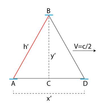

The first thing i want to point out is that a photosensitive plate must actually be thought of as a set of spatially separated observers. The very fact that you need multiple detector cells, or that each detection occurs at a different place in the plate, is enough to demonstrate this.
The setup should have the observer fixed at some origin. Consider this:
All lengths and distances are primed because they are all locally measured numbers. If you like, imagine that before the experiment we have walked all the distances and measured them with a measuring rod. You can even imagine that we have marked each km with a big sign with the km distance painted on it, so even in the moving system S we know the primed spatial coordinates from direct observation.
Fix an obsever at A, his frame denoted by S.
V=c/2= the velocity of the light clock in the x direction, as shown on the onboard speedometer. Also, this velocity has been previously agreed upon, so there's no doubt that's the speed of the light clock.
BC=y'=1 lightsecond = the distance between mirrors (measured locally, remember) and this is a given.
AC=x't=0.5 lightseconds = distance traveled by the light clock in the x direction between reflection events TA and TB
TA=T'A= 0 = time of first recorded reflection, at both S and S' origins, which are both at A.
T'B=1s = the time of the second reflection event as calculated in the rest frame S' (I say calculated because it is half the time between two consecutive observed reflections in the bottom mirror, where we can assume the observer inside the light-clock would be fixed at)
TB=T'B + h' = the moment a reflection signal (i.e.: scatter event) from B is seen in S, which is the the time light takes to travel from the reflection event T'B to the observer at A.
This triangle represents the first two reflection events as seen in the moving frame S, where one mirror is seen at A when T'=T=0 and the other at B when T'=1, which are separated by y'=1 lightsecond.
The light clock is going at .5c, and this is given by an onboard speedometer, and has been decided from the begining, so the observer in S can assume it as given. But this velocity is only useful in this setup to determine AC. Since we are trying to get numbers from the beam going AB, that's where S should fix the x axis, just like in the train problem.
AB = h' = 1.12
TB = T'B + h = 2.12s
VAB = h'/TB = .53c
That's what the observer at A would conclude. You will say that we can't do it this way because we are using primed values for distances, and while S would really see them compressed, he can use primed numbers because they are already marked, so we can skip all the transforms.
It is also curious to notice that VAB is different from V'AB, and that this would seem to imply that the speed of light is not the same for all observers. This is the most important place to reestate that the beam is NOT observed in the same manner that we observe light. In this setup, the observations are of events (scatter events, radio signals, etc), and we receive the data from these events through EM waves, and it is those waves that always travel at c: detected light. Seeing light by secondary means can very easily change the relative speed of light, that's why I believe it is of great importance to remember always that we must consider light detection as a local event in all relativistic problems.
As a footnote, I want to point out that doing the inverse processo, using the unprimed values and transforming them into primed values, or correcting the speed of the beam to c, will result in the beam covering a straight line with the same length as y', and since we know from experiment that light travels at c, it must do so inside the lightclock as well, and that's how we would correctly diagram the behaviour of the beam, if we want to keep it's velocity as c. And that's why I have been saying that the only way we would correctly diagram the path of the beam is in the stationary frame. Light detection always occurs locally, and any .
My last remark is that it seems impossible to use the lorentz transformations consistently in this setup. First, it is hard to decide which V to use, since they are not the same for each observer, and secondly, the values don't add up either way. And if we plug in c for the speed of the beam, gamma vanishes, as we all know.
As it is, we have no clear position for the observer. As has been proposed in this discussion, we may include an observer that is large enough to cover the entire distances with, but that can only be consistent with SR if it is thought of as an array of observers. A single observer in SR must be thought of as a point at the origin of its own frame of reference, where observations are made from - or we should take the spatial separation between detections into account.
If you don't agree with the above, even if you're able to correct my analysis, I would like to see how you would deal with the setup such as I presented, with the same givens.

I haven't been following this thread closely, but I'll take a crack at re-stating the problem and then giving a quick analysis.
You have basically defined four events, which I'll label A0, B1, C1, and D2:
A0: The light clock pulse is emitted.
B1: The light clock pulse bounces off the mirror.
C1: The spatial location of the light clock source/detector "when" the light clock pulse bounces off the mirror. We'll defer discussion of this event for a bit.
D2: The light clock pulse is received.
In the primed frame (i.e., the rest frame of the light clock), three of these events have coordinates (if I've understood you correctly), given as (t', x', y'):
A0': (0, 0, 0) -- the origin of the frame
B1': (1, 0, 1) -- the mirror is 1 light-second away from the origin in the y direction, so light takes 1 second to get to it. No distance is traveled in the x-direction.
D2': (2, 0, 0) -- light takes another second to get back to the spatial origin, where the source/detector sits.
Now we want to transform to the unprimed frame, in which the light clock is moving at v = 0.5 in the positive x direction. That means our transform from the primed to the unprimed frame uses a v of *minus* 0.5 in the x direction. The transformation formulas are thus:
t = 1.16 (t' + 0.5 x')
x = 1.16 (x' + 0.5 t')
y = y'
where 1.16 is the gamma factor associated with v = 0.5. This gives for the three event coordinates in the unprimed frame (t, x, y), where I have assumed that event A0 is the common origin of both frames:
Using your terms, the events would actually be:
A0: The light clock beam is emitted/reflected from bottom mirror.
B1a: The light clock pulse bounces off the top mirror - in the direction of the bottom mirror (towards D in the unprimed frame).
B1b: The mirror emits a signal towards A.
A2: The signal reaches the observer at A.
D2' doesn't enter the problem, since we are seeking just the time of the reflection on the top mirror and the behavior of the light beam from A to B from the point of view of the observer at A. We could include a third event in place of D2' which would be the time the observer receives the signal as seen from the light clock, but that is not what we are concerned with.
Now we want to transform to the unprimed frame, in which the light clock is moving at v = 0.5 in the positive x direction...
y = y'
...1.16 is the gamma factor associated with v = 0.5...
That can't be right, although I see your reasoning. Your are calculating gamma using the speed of the light clock, but we must place the x-axis in line with the beam (which would be h'), because we are seeking values for the beam itself. All your subsequent coordinates are then jeopardized.
Now let's talk about event C1, the one I deferred discussion of. The way you have defined it, its coordinates in the unprimed frame should be:
C1: (1.16, 0.58, 0) -- the source/detector in the light clock has moved along with the rest of the light clock in the x direction, but it remains at y = 0.
But notice that this means the light clock has traveled 0.58 light seconds, according to the unprimed frame, between the events you are calling TA and TB (and I am calling A0 and B1). If we now transform back to the primed frame, we find that the primed coordinates of event C1 are:
C1': (1, 0, 0) -- the source/detector stays at the spatial origin at all times in the primed frame.
Of course the conclusion that the detector stays at the origin is correct. But gamma is not correct here. Also, you are using 0.58 for the distance traveled from the point of view of the observer at A, but remember the only way the observer has to know this distance would be by knowing the velocity, but he knows only the speed of the light clock, not of the beam (he has to calculate it). You may say that he does know the speed of the beam, since it must be c, but that's an assumption I want you to hold for a second and imagine how that would actually be measured. That's why I placed km signs at every distance, so the observer can use the primed spatial coordinates to get the velocity and do the transforms.
The above analysis looks correct to me, and I don't see any paradox anywhere; it just requires being careful about defining events and frames.
The problem with your analysis and what I have been saying from the start is that the reflection event at T'=1s is not directly observed, it can only be calculated from some sort of signal emitted from the top mirror (B). And that has to be achieved by taking the primed space and time coordinates of that event and adding the time it takes for the signal to reach the observer.
Also, you are using the velocity of the light clock in the x direction, but that is only useful to determine the length of the opposite side of the triangle, so we find the hypotenuse (h') and calculate the time it takes the signal to reach A. I know this is confusing, but bare with me. Remember the train and embankment problem? We fix the x-axis in line with the tracks, because we are seeking numbers for the train. Here, we are seeking numbers for the beam, so our x-axis must be fixed in line with the path of the beam (h'), and plug in the speed of the beam. You can't plug in the speed of the light clock in the x direction, since that would only work if we were seeking numbers for the light clock's motion, which is not the case. Just as we plug the speed of the train to find gamma, we must use the speed of the beam here in the same way.
Another remark, it seem you are imagining the beam returning to the unprimed origin or something like that, but we don't need to worry about the path of the beam after this reflection. But if we were to take this into account, the beam moves back to the bottom mirror some further distance away (in the unprimed frame). The observer never sees the beam directly, the beam is always moving away from A, so it never reaches him. We need another light source reaching that observer bringing information from the beam if we want him to see anything. If we send a signal from the top reflection event (at T'=1s), and we are given the primed coordinates of that event, we just have to calculate how much time it takes for a light signal from B to reach the observer at A and calculate the speed of the beam from that. Remember that distances are given and times are observed in my setup, and we are given the speed of the light clock, but the speed of the beam can only be c over an assumption, otherwise it becomes clear that c only applies to light that reaches the observer, which is what I believe the postulate of the speed of light really means. We never see Einstein talking about the speed of light at a distance, since that light is plainly undetectable. It is a constant relative to the source and the observer, but that says nothing about the speed of light relative to a non-observer.
At the very least, even if you don't agree with the bulk of my analysis, I think it should be clear that the present light clock diagrams are illogical, or incomplete, since the position of the observer is never defined, nor the process by which the beam's path is determined in the unprimed frame.

[..] notice that if you apply the same setup for the train and embankment problem, your observer (plate) will cover the entire length of the tracks, from the origin to the end.
Multiple detector cells imply a timespace separation between them, which is not consistent with the notion of a single observer, since an observer can't be at any distance from himself. Every single cell must therefore be a unique observer.
Somewhat yes, as I earlier elaborated: every CCD is a separate detector, and the same for the at those points located quartz clocks in my example. An observer collects all the recorded (x,y,z,t) data and constructs either an (x,y,z) trajectory plot or an (x,y,z,t) "space-time" plot. According to SR, if the clocks were synchronised to the rest frame of the position detectors then the laws of nature will work fine for the "space-time" plot.
Which is exactly the contrary of what you claimed:
"by taking notes of the times of each x,y position, and the length of the line imprinted on the plate, you will directly calculate light to travel faster than c"
And thus your attempts to "solve" the problem as follows:
[..] my first argument, actually, that everything from the primed frame has to be signaled to the observer, orherwise he can't observe anything and we can't even begin to make the setup logical. [..]
However, such an attempt to avoid looking at the collected data is, as I stated, and as probably PeterDonis now clarified (I have not looked at your and his calculations yet), not at all what SR pretends; and what SR pretends is not a problem.
And it matters, as you will see later on, because the times and distances of these signals must enter the calculations.
Yes of course. As you might have seen, I implied that in my post #63 with as many according to you "impossible" information points as you could want. And as for your calculation, I will look into that later - if that still has any use, in view of already someone else having done so.

And? Would that represent what a single observer observes? This is the detection plate all over again. That is useful if we are seeking local data, but if I am given local distances and times, as in the proposed setup, it just confirms the givens.
Are you concerned that in the moving frame the light has two components of velocity ? Because that is a mere coordinate effect and can be removed with a spatial rotation.

He clearly fixed the observer at the origin A, and his numbers depend on this position. It can't be irrelevant because it changes all times and distances. Is fixing the observer at the embankment (origin) irrelevant in that famous thought problem?
  • #78
Are you saying there are two light pulses inside the light clock? I thought there was only one (and your picture shows only one), in which case events B1a and B1b are identical.
Neither of these even happen, they violate the laws of optics. The angle of reflection equals the angle of incidence, so the reflected signal goes towards D, not A.
Nonsense, the x-axis is not in line with the beam in either frame. All of his coordinates are correct.
You are correct, that was a typo from my part, the mirror sends/reflects a BEAM towards B, and B sends a signal towards A at the moment of reflection. Of course the reflected beam moves towards D, that's why the observer at A can't see it and determine it's coordinates directly.
Substitute the beam for the train, and the point A for the embankment. Where would you align your x axis? You can completely remove the light clock itself from the situation, after you find the opposite side of the triangle ABC. We are not seeking numbers for the light clock, we are seeking numbers for the beam, here. Remember, we are NOT seeing the beam directly.
If you are not using that assumption then you are not doing relativity, but are simply speculating, which is against the rules here.
I am not speculating! Just the other way around, I am checking to see if the unprimed frame actually sees that beam go at c. First we agreed that he didn't see it, so we made the setup work so that he did, somehow (through scattering or reflection times signaling). Now, all I am doing is using that received data to check the beam's coordinates from the unprimed frame's point of view. That's what we would do if the beam's path was flown by a rocket, for instance. My assumption is simply to give c to any and all light that we receive, and use that information to check the speed of the beam, since we can't really measure it's velocity directly.
So what? You repeat this trivially true statement that has no bearing on the analysis as though it is some profound insight instead of an obvious distraction. This has no bearing on the operation of the clock itself. You can send signals via EM, sound, or even FedEx. The clock doesn't tick faster or slower.
I reiterate the question I posed back in post 64, which you avoided. How does the manner of transmitting the information to a remote observer change the operation of the clock in any way? How does broadcasting a tick using light or sound or paper printouts after the tick change the time it takes for the clock to tick? That seems to violate causality.
Because it is not trivial, Dale! To answer your question, it doesn't. The manner of transmitting data just delays the time of reception, causing an apparent time dilation. If you turn on a light at some agreed upon time, I will see it lit later, and more the further we are. If I write "it's 9PM now" and give you this note one hour later you will not agree with the note, but will understand it took one hour for the note to reach you, which is all I am doing here. I am taking events in the primed frame and seeing at what times the observer in the unprimed frame will see them, assuming all data reaches him at c. That's it!
