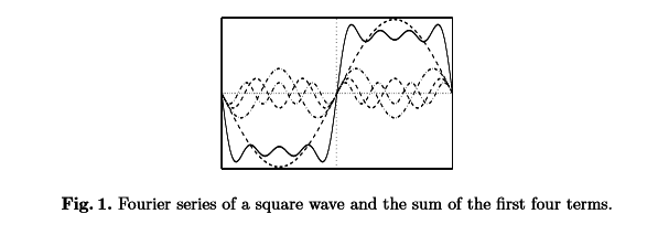

edges and corners are where the Fourier components are maximally in phase
if you've ever manually (that is with pencil ruler and paper) plotted a square wave as sum of its first few Fourier terms it seems intuitive.
The steepest slopes occur where the Fourier terms come in phase, ie their individual steepest slopes (zero crossings) coincide.
Same author, more detailed presentation
http://www.csse.uwa.edu.au/~pk/research/pkpapers/phasecorners.pdf
see section 2 fig1 on page 3, it shows that square wave exercise
were that part of an old fashioned black&white NTSC video signal, it'd change from very dark to very bright right there in the middle.
Note that's where all your components have briefly come into phase with one another. It's obvious from the picture but probably not from just the list of (nωt + Φ) terms
