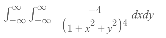

Dear all,
Last semester on the final exam, our professor gave us an integral that seems difficult to solve.
The integral came at the end of a lengthy problem, where we were asked to find the net Gauss curvature of Enneper's surface.
The integral that emerged is the following.
We tried substituting x = sinθ, y = cosΘ and ended up with
which does not help.

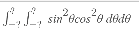

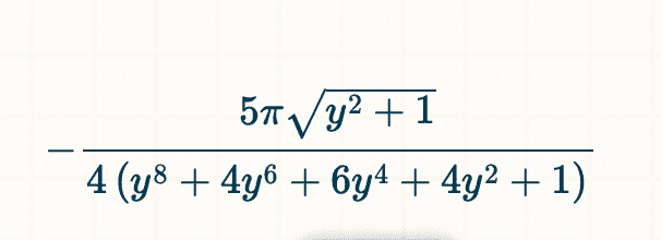

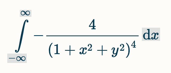

We tried evaluating the following single integral to see if it simplifies.
...And the calculations continue for another 3 pages and become more complicated.The evaluated integral is the following.
We could integrate this expression with respect to y and evaluate the result from -∞ to ∞ .
The answer for the net curvature is - 4π in differential geometry textbooks.
Is there a key integration technique we are missing?
This integral seems difficult to solve without using technology.
Thank you.
docnet said:
Homework Statement:: Evaluate ∫∫ -4 / (1+ x^2 + y^2)^4 dx dy
Relevant Equations:: ∫∫ -4 / (1+ x^2 + y^2)^4 dx dy
Change to polar coordinates.

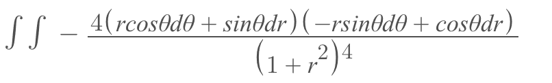

Dear @Mark44 and @George Jones,
Thank you for your suggestions.
We substituted x = r sinΘ, y = r cosΘ and used the chain rule to determine dx and dy.
The new boundaries of integration in polar coordinates are determined by the sets {0 ≤ r ≤ ∞} and {0 ≤ Θ ≤ 2π}.
We then expanded the numerator to obtain the following integrals.
Evaluating the first integral
We try substituting r = tan2u to simplify the process, and treat sin2Θ as a constant. The new boundaries of integration are determined by the set {0 ≤ u ≤ .5π} and we have
to be continued.
When you convert from rectangular to polar, dxdy becomes ##rdrd\theta##, so the numerator will become ##-4rdrd\theta##.

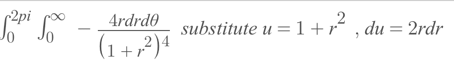

@Mark44
Thank you for pointing out my error. This would have been a time sink.
So we have
and
and
Which is our net Gaussian curvature of Enneper's Surface.

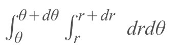

@George Jones,
Integrating 1 to determine the area, we have
The textbook gives the net curvature of Enneper's surface as - 4π but frankly I don't know if that is equal to the net Gaussian curvature. I assume they are different.
Let's do this a little more intuitively. Since ##dr## and ##d\theta## are "infinitesimally small", the bounded area is a "rectangle". What are the lengths of its sides?
Since a length of an arc of a circle is the radius times the angle, we have a rectangle of side dr and side rdΘ. length rdΘ corresponds to the side perpendicular to the radial direction.
The corresponding area is r drdΘ, that is congruent to our infinitesimally small area element dydx in rectangular coordinates.

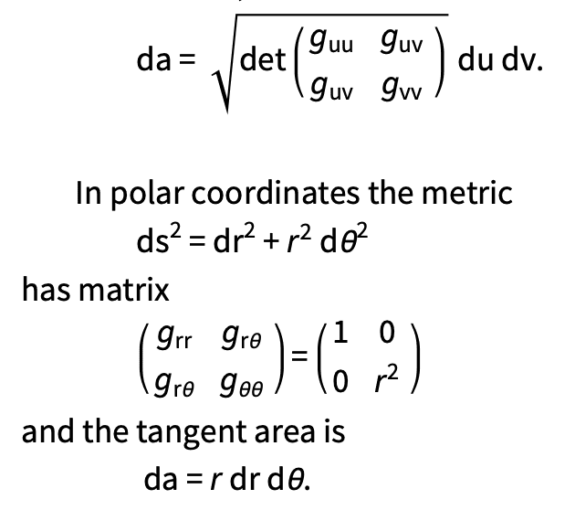

@Delta2.
The description of the parallelogram in the wikipedia link feels reminiscent of the geometric representation of the determinant of a 2 x 2 matrix.
In differential geometry, we learned the area factor corresponding to the metric is determined by taking the square root of the determinant of the metric.
I assume this is equivalent to the Jacobian method you mentioned?
Ok, I frankly don't know the method you are saying, it uses the square root of the determinant of a different matrix (not the Jacobian matrix) but it gives the same result, at least for two variables.

if ##J## is the jacobian matrix as you have it in post #17 then it is $$df_1df_2...df_n=|det(J)|dx_1dx_2...dx_n$$ when we change the variables from ##f_1,f_2,...,f_n## to ##x_1,x_2,...,x_n##.

rcos2Θ + rsin2Θ = r
which gives our change of variables from xy space to polar coordinates.
dxdy = > rdrdΘ
