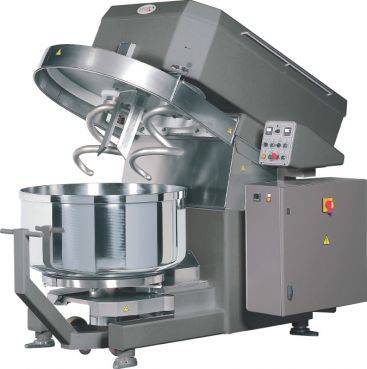

Electric mixer. Obvious now.

Well, in an industrial mixer. I think Average is correct.
If you wish to re-use it, you could take the head off, and you'd have a powerful electric motor for something. Don't know what the revs are.
