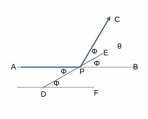

The mirror in the image below deflects a horizontal laser by angle θ. What is the angle φ if θ = 60°.
θir
So I know that, if I draw a line normal to the mirror, that will make it so that the incident angle and the reflected angle equal 60° (since 180-60=120 and the 2 angles have to be the same, so 120/2=60) but after that, I have no idea what to do. I know the angle is 30°, but how did they get that angle. Maybe I just need to reviw my geometry.
Draw the normal to the mirror and identify the angle of incidence and the angle of reflection.
[Edit] ... also derive the equation rrlating the angles first, then plugbin the numbers
Take care with notation.
Yes, you'll get nowhere without your junior high geometry. Relationships expressed concisely as "co-interior angles are supplementary", or maybe use "alternate angles are equal".
We don’t need no stinkin’ normals. (See note below.) All we need is a suitable diagram…
This immediately shows that θ = 2Φ.
I think I've told you too much. But can you explain why the marked angles in the diagram are equal to Φ?

yes it has to do with reflection angles:
E=180
P vertical=90
and we have 60 degree
The unknown angle is = 180 - 90 - 60 = 30 degrees
