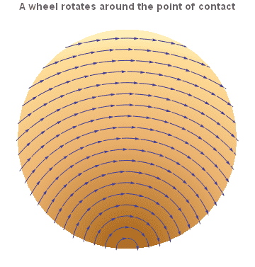

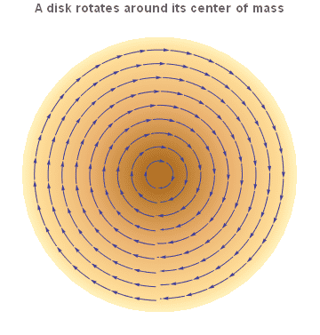

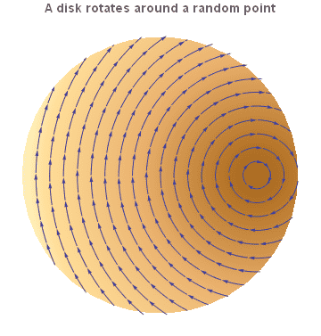

  • #79
Dale said:
Any infinitesimal rigid body motion can be described as an infinitesimal translation of any arbitrary material point on the body and an infinitesimal rotation about that point.
John Mcrain said:
Dont understand this concept "it can rotate around any point"...
This is just a mathematical fact of rigid body motion, purely kinematically. It has nothing to do with forces, just the way that rigid body motion behaves mathematically.
Suppose I have a rigid disk which is spinning about its center of mass. At a given instant I can plot the velocity of each point on the disk as follows:
The formula for the velocity field is ##\vec v=(y,-x)##. This is rotation around the center, as expected.
However, suppose instead of a disk rotating, we have a wheel rolling. Kinematically these are the same motion in different reference frames. Then at any given instant I can plot the velocity of each point on the wheel as follows:
The formula for the velocity field is ##\vec v=(y,-x)+(1,0)##. Notice that this motion is also a pure rotation, but about the bottom of the wheel, the point that it contacts the ground. Again, this is kinematically identical to the disk rotating about the center in a different reference frame.
These two points are not special. In fact, for any point on the wheel you can pick a reference frame where that point is momentarily at rest. When you do so the motion is as follows:
The formula for this velocity field is ##\vec v=(y,-x)+(0,0.7)##. Notice again that this motion is momentarily a pure rotation about the chosen point which happens to be ##(0.7,0)##.
This is a general feature of rigid body motion. You can always decompose the velocity of the material points in a rigid body into a pure rotation about any point and a rigid translation.
So again, it isn't that the rotation is about the center of mass, but that the translation of the center of mass is particularly simple.
  • #80
Notice again that this motion is momentarily a pure rotation about the chosen point.
This last diagram is hard to coprehend..
  • #81
There exists a frame where the motion is momentarily pure rotation about the random point. It is just to show that neither the center nor the edge are special points. Any point can be considered the center of rotation.
