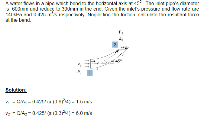

why z1=z2 ? isn't the position 2 is higher than position 1 ?
  • Diagram of a pipe bend with a water flow: section 1 at the inlet labelled P1, A1, v1, and section 2 at the outlet labelled P2, A2, v2, with the bend angle theta = 45 degrees marked, and the solution lines v1 = 1.5 m/s and v2 = 6.0 m/s written below.

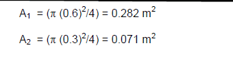

  • Two equations in plain typeset text: A1 = (pi (0.6)^2/4) = 0.282 m^2 and A2 = (pi (0.3)^2/4) = 0.071 m^2.
The question is rather unclear, but I believe the diagram is the plan view, i.e. looking from above. (It doesn't say "45 degrees to the horizontal".)
the height of both are not the same, right??
No, I'm saying that the flow is all at the same horizontal level. Reread what I posted before.
if this is side view , the ther must be some value for z , right ? z can't be equal to 0 ?
haruspex said:
but it isn't.
sorry , what do you mean ? i didnt get you
It's the plan view, i.e. you are looking down onto the pipe from above. The z direction is out of the page. The flow is all on one horizontal level.
if this is a side view , then z can't be = 0 , right ?
If it were a side view, that would be true.
