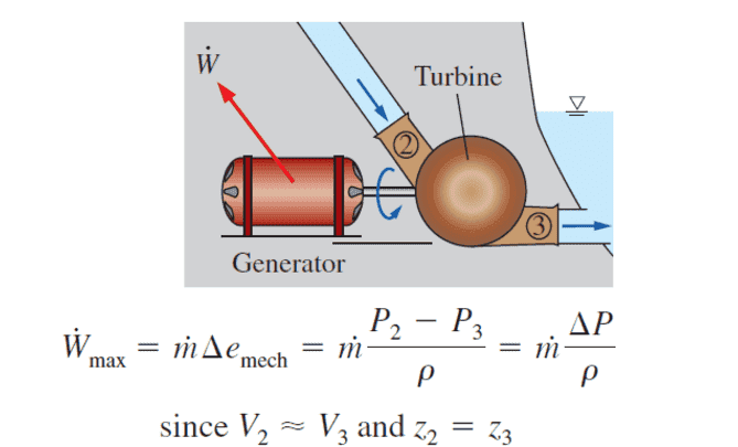

Why is the height of point 2 same as point 3?
The discussion centers on the observation that the height of point 2 is the same as point 3 in a turbine setup, attributed to the small height differences within the turbine. It raises the question of whether this equality is an assumption due to the minimal height variations. The conversation also notes that different types of turbines are employed for smaller height differences. Additionally, there is curiosity about the absence of the approximation symbol "≈" in the context. Overall, the dialogue explores the implications of small height differences in turbine design.

Is it an assumption because the difference in height is small?

With a setup as shown height differences within the turbine are very small.
For smaller height differences, other types of turbines are used.
Likes EastWindBreaks
I wonder why it didnt use "≈", thank you!
