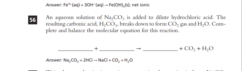

An aqueous solution of Na2CO3 is added to dilute hydrochloric acid. The
resulting carbonic acid, H2CO3, breaks down to form CO2 gas and H2O. Complete and balance the molecular equation for this reaction
Hello,
Can I get some clarification on why it is NaCl and not 2NaCl as a product please?
Thanks in advance!
I had ##Na_2CO_3 + 2HCl## --> ##2NaCl + CO_2 + H_2O## instead. Why is this not correct?
I have this as shouldn't the number of chlorine and sodium atoms be the same in reactant and product side?
simphys said:
Homework Statement:: An aqueous solution of Na2CO3 is added to dilute hydrochloric acid. The
Relevant Equations:: /
Hello,
Thanks in advance!
That is what I get also. Perhaps we are missing something obvious, @Borek will spot it?
Likes simphys
The 2 is missing, simple typo.
Likes pinball1970 and simphys
The answer given does not have the same number of Na and Cl atoms on both sides of the reaction, so it must be wrong.
Likes jim mcnamara and simphys
What I assumed as well, thank you.
Likes pinball1970

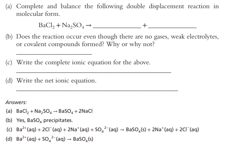

hey @DrClaude (or anybode else :) )I didn't want to open another thread for this small question but I wanted to ask the following:
it's about question (a): I was wondering what the reason 'd be not to write ##Na_2Cl_2## instead of 2NaCl?
my possible explanation, because the ionic compounds dissociate in water(aq solution) where we get 2 Na+ions and 2 Cl- ions(and 1Ba(2+) and (SO4)2-) from one molecule of the compounds seperately which then 'supposedly' form NaCl.
simphys said:
(a): I was wondering what the reason 'd be not to write Na2Cl2 instead of 2NaCl?
Sodium Chloride is not any single molecule. The compound is sodium cations and chloride anions, ratio one-to-one. ONE such unit we symbolize NaCl. Two such units we can show as 2NaCl. If you try to say, Na2Cl2 this suggests you are saying The unit is like a molecule having two of each ion, which it is not.
Likes Merlin3189
The key word in the question is BALANCE - your task is to work out how many of each compound there should be in the final balanced equation. It's NOT a typo in the question, it is an unbalanced equation for you to make balanced.
So your answer is correct.
Because of 2HCl on the left it doesn't look like a skeletal equation waiting to be balanced.
Nobody has said it was a typo in the question, it's clearly a typo in the ANSWER.
