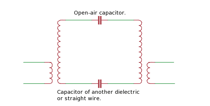

Okay, now I see that I wasn't clear enough. Sorry.
The LED test and the efficiency test were two separate tests. In the efficiency test, the 10 ohm resistor was the load impedance. The only component connected across the terminals of the primary coil, which means all the current in the primary goes though it. At the transmitter end, a 10 ohm resistor was connected in series with the primary and function generator, again all the current from the function generator goes though the 10 ohm resistor. My teacher was following the experiment and I can assure you I did everything with great care.
I hope I didn't upset you. I don't have a fraction of the knowledge and experience you have. I'll take your advice and learn more :)
I hope to take pictures and more accurate measurements of my new setup when it's finished.

My point is that your 10Ohm resistor measurement will not tell you the power unless you know source and load impedances. If you have resonant systems it is even less easy. So, apart from the fact that you lit your diodes, you cannot know the efficiency.
But there are two entirely separate issues here. You have shown that it is possible to get good coupling between a source and load, using a transformer but that has nothing to do with the notion of getting energy from other, unspecified, sources of RF energy. You did not take my point about Conservation Laws, but they apply here the same as anywhere else and they are the basic objection to 'excess energy' and also to this. Going back a bit, you are actually suggesting the equivalent to a 'Maxwell Demon', which has been put to bed long ago.

I'm amazed about the claim of 90% efficient transfer of power from one coil to another. What if another coil were put nearby? Would that get 90% of the power too? 180% of the input power would appear. That would be amazing good value.
  • #52
No. The input power would be shared between the two receivers. Tesla coils are "transponders" rather than transmitters and receivers.
  • #53

It's a transformer, in fact. Where's the magic in that? Not all transformers are made of iron and handle mains electricity.
I wish someone could tell me what's supposed to be different about these things with the name 'Tesla' attached to them. Transformer windings are essentially magnetically coupled coils because it is a near field effect and the impedance is not the same as for free space.
This way of close-coupling small pieces of equipment to a power source could have useful applications (subject to the interference levels being controlled). A 'charging table' would be another step up from 'the dock'. Efficiency need not be high because low power is involved.
But there seems to be some confusion about the distance over which this type of coupling exists. It is only in operation within a wavelength or so from the primary / transmitter. Only a 'free wave' will propagate over longer distances and energy can only be 'directed' using a large aperture antenna. Furthermore, the mutual impedance between wide spaced transmit and receive array is low (a receive antenna can't "suck" energy from the source). You cannot avoid 'wasting' most of your power and it is a brave man who disputes Maxwell's Equations.
People go and spoil it all by extrapolating a near-field process to long distance high power transmission as if it's the same thing. Tesla had a number of totally off the wall patents which are fully available for development but have never been (they were duff); there is no implication that a patented idea will actually work. Likewise, there may well have been uninformed pen-pushers in the Pentagon (or whatever it was called at the time) who decided that one or two of his untested ideas were a potential threat. There was no need to justify these decisions on rigorous technical grounds. Once declared secret, they were hidden from normal scrutiny and are not available for a healthy scrutiny /de-bunking. They just sit there, proving to the gullible that they are suppressed by that great conspiratorial body they love to hate. Tesla must be chuckling in his grave.

It would really help if you were to draw a diagram of what you see is going on here. The capacity between two spheres, separated by a few metres is extremely small ( a few tens of pF). The 'other ends' of the coils would be 'grounded' in some way, I imagine. With a stake in the ground or in a pool of water would make little difference. It's just an Earth connection between the two bases which would usually be best with a 'copper' plane between the two coils but a few wires would be almost as good.
There will be a mutual inductance between the two coils and a (tiny but finite) capacitance between them. That will be the coupling mechanism between the two in the near field. The far (radiated) field will not have established itself for a small separation but the currents in the two coils will be the result of the Impedance Matrix - self and mutual impedances and the 'drive point' voltage. Having resonant structures will give you effectively much bigger 'elements'. This is just an extension of the idea of top or bottom loading short monopole antennae.
btw, what sort of Q do you reckon you are finding for these coil / ball structures?

Here. This is how I think it works.
The capacitance is indeed very small. A friend of mine did some calculations and said it would be very unlikely for my coils achieve distances beyond ~100 meters. And this was for my first set of coils which operated at ~14MHz.
I can think of three ways to improve the distance: raising the voltage, installing a bigger sphere on top of the coils and using higher frequency.
I have not been able to test the Q of my coils in operation. I don't even know how to do it. If I remember correctly the LCR tester thingy showed a Q ratio of 5.5 for each of the secondary coils and 5 for the primaries. I am not sure about this though, and I don't know whether the tester is accurate.
