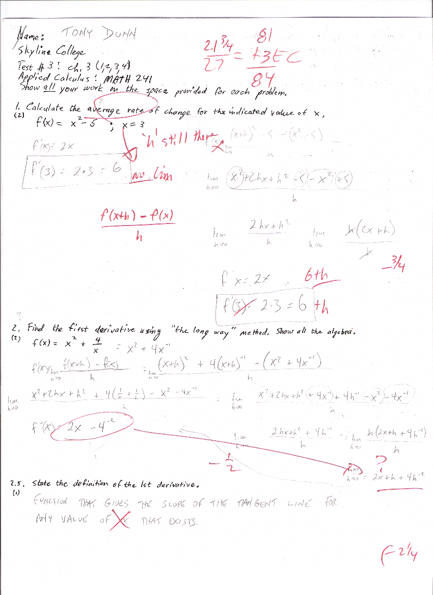

  • #49
tony873004 said:
Calculate the average rate of change for the indicated value of x.
f(x)=x2-5; x=3
Since we were not prohibited from using the power rule, my answer was:
f'(x)=2x
f'(3)=2*3=6
My score: 1.25/2
What the teacher wanted is:
6+h.
My reasoning as to why he's wrong:
6+h would be the average rate of change for [x, x+h], but not for x.
x is a single point. It's like asking what's the batting average of a player who has 1 hit in 1 at bat. It's 1/1. Here too, with only a single point, the denominator of a fraction designed to compute an average must contain a number n=number of data points.
So the average rate of change for a single point should be the instantaneous value of that point.
Again, thanks to everyone for playing the part of the teacher in debating against me.
the question as stated here does not make sense. To calculate an average rate of change, on must always be provided with an interval. But I have the feeling you are not really giving the full question! his answer contains "h" and you don't even mention h in the question! Are you sure he did not asked the average rate of change between x and x +h or something like that?
You cannot replace average rate of change by a derivative. These are different things. (only the limit as the interval goes to zero do they become equal)

In this case, if that had been the question exactly as it was posed, and your teacher had expected an answer of (6 + h), yes, your teacher is wrong. I can't even begin to see where the h would suddenly come from.
Do post the whole question, you might actually be right in this instance ! :smile:

I get his answer if the question was "what is the average rate of change between x and x+h", where x=3. This is just (f(3+h) - f(3))/h.
If the question was not stated this way, then the question does not make sense.
But in any case, it would still be incorrect to use a derivative which gives the instantaneous rate of change.
I would say that you cannot argue that your answer is correct.
But if the question was written exactly liek this, then it should be dismissed entirely because it was not properly phrased.

  • #54
nrqed said:
...But I have the feeling you are not really giving the full question!
Am I really that untrustable :devil: ?
I scanned it:
http://orbitsimulator.com/BA/test3.GIF
Are you a calculus teacher, nrqed?
btw. I'm still stuck on #2. I got the right answer because it was simple using the power rule, but we were not allowed to use the power rule here. The teacher noticed that my algebra and my answer didn't jive.
The teacher is very cool. If we make corrections on the missed problems, and turn them in, he adds a few percentage points to our grade. I stand to gain an additional 3.2%, so if anyone can point me in the right direction with #2, I'd appreciate it. I get stuck because I don't know if pulling /(x+h) up to the numerator making (x+h)-1 was the right way to go. And if it is, I still don't know how to proceed.
I asked this last night. Galileo responded, but I don't quite follow what he's doing.
https://www.physicsforums.com/showthread.php?t=115242
  • #55
Not at all :frown:
I meant to say that I had a feeling you had forgotten to include a line of the question..
Then, if you want my honest opinion, the question, as it stands, makes no sense. An interval must always be provided to calculate an average rate of change.
If I would have walked in for the test, sat down and read the question, I would not have been able to answer despite my PhD in theoretical physics. Because it is assuming something which is not standard (that he wanted the average rate between x and x+h).
I can only guess that he has done lots of example where average rate always implied between x and x+h and that he assumed that everybody was so used to that that he did not need to be clear in the question. But to be honest, it is not a sensical question as it stands.
I can see why, without an interval specified, you might ahve been tempted to use a derivative (even though this is not the correct answer for the question...but the question is incomplete so I can see why you could be tempted to do something else that what was actually asked).
I teach physics.
I will have a look...
Pat

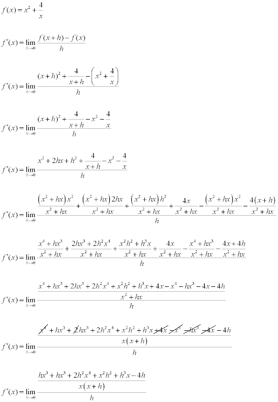

  • #57
Thanks, Pat. Physics is my favorite subject.
Am I on the right track here?
This might be a little more readable:
http://orbitsimulator.com/BA/question2.gif
<br /> \begin{array}{l}<br /> f(x) = x^2 + \frac{4}{x} \\ <br /> \\ <br /> f&#039;(x) = \mathop {\lim }\limits_{h \to 0} \frac{{f(x + h) - f(x)}}{h} \\ <br /> \\ <br /> f&#039;(x) = \mathop {\lim }\limits_{h \to 0} \frac{{(x + h)^2 + \frac{4}{{x + h}} - \left( {x^2 + \frac{4}{x}} \right)}}{h} \\ <br /> \\ <br /> f&#039;(x) = \mathop {\lim }\limits_{h \to 0} \frac{{(x + h)^2 + \frac{4}{{x + h}} - x^2 - \frac{4}{x}}}{h} \\ <br /> \\ <br /> f&#039;(x) = \mathop {\lim }\limits_{h \to 0} \frac{{x^2 + 2hx + h^2 + \frac{4}{{x + h}} - x^2 - \frac{4}{x}}}{h} \\ <br /> \\ <br /> f&#039;(x) = \mathop {\lim }\limits_{h \to 0} \frac{{\frac{{\left( {x^2 + hx} \right)x^2 }}{{x^2 + hx}} + \frac{{\left( {x^2 + hx} \right)2hx}}{{x^2 + hx}} + \frac{{\left( {x^2 + hx} \right)h^2 }}{{x^2 + hx}} + \frac{{4x}}{{x^2 + hx}} - \frac{{\left( {x^2 + hx} \right)x^2 }}{{x^2 + hx}} - \frac{{4\left( {x + h} \right)}}{{x^2 + hx}}}}{h} \\ <br /> \\ <br /> f&#039;(x) = \mathop {\lim }\limits_{h \to 0} \frac{{\frac{{x^4 + hx^3 }}{{x^2 + hx}} + \frac{{2hx^3 + 2h^2 x^4 }}{{x^2 + hx}} + \frac{{x^2 h^2 + h^3 x}}{{x^2 + hx}} + \frac{{4x}}{{x^2 + hx}} - \frac{{x^4 + hx^3 }}{{x^2 + hx}} - \frac{{4x + 4h}}{{x^2 + hx}}}}{h} \\ <br /> \\ <br /> f&#039;(x) = \mathop {\lim }\limits_{h \to 0} \frac{{\frac{{x^4 + hx^3 + 2hx^3 + 2h^2 x^4 + x^2 h^2 + h^3 x + 4x - x^4 - hx^3 - 4x - 4h}}{{x^2 + hx}}}}{h} \\ <br /> \\ <br /> \end{array}<br />
<br /> f&#039;(x) = \mathop {\lim }\limits_{h \to 0} \frac{{\frac{{hx^3 + hx^3 + 2h^2 x^4 + x^2 h^2 + h^3 x - 4h}}{{x\left( {x + h} \right)}}}}{h}<br />
If this is correct so far, I'm stuck here.
  • #58
you are making it more complicated than it needs to be!:wink:
You Can do the limits applied to each term separately. The x^2 bit does not require you to put over the denominator of the other function...Do it separately, it's the easy one. Do the 1/x separately and I gave you all the steps
Pat
  • #59
But as long as he got that far, we might as well nudge him the rest of the way!
tony: I think your problem is just that you haven't simplified your fraction. What is:
<br /> \frac{a}{b} \div c<br />
  • #60
See your other thread, I've solved it there. https://www.physicsforums.com/showthread.php?t=115242
