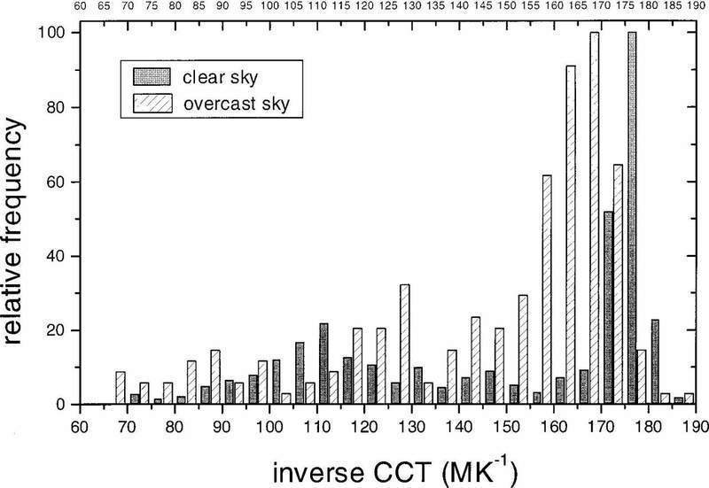

In Color and spectral analysis of daylight in southern europe, there is a histogram (see attached) that suggests CCT is uncorrelated with the existence or absence of cloud cover.
Very curious if anyone knows of the atmospheric physics that explains this, or can point me in the right direction. What explains such wide variations in the peak wavelengths of the daylight spectrum?

Well, I guess that's the common sense mechanism that we expect or that we have been told, but the data suggests otherwise. The histogram attachment shows there is little to no correlation between cloud cover and CCT. High and low CCTs occur on both cloudy and clear days. Which leaves me still searching for a mechanism that explains the data we see.
What? The paper linked in the 2nd post, where the graph comes from, states otherwise.
Figure 5 shows the h0 dependence of CCT for clear and
overcast skies. The mean CCT for overcast skies is
greater than that for clear skies, as is its variability (for
h0 . 10°, the overcasts’ mean CCT exceeds that for clear
skies at the 5% significance level).
The mean CCT is greater, meaning the wavelengths measured from the sky are longer on average. Keep in mind this is coming from multiple days, not just one, and cloud cover varies significantly.

But the paper also says:
As it indicates, clear skies occur ;3.5 times more frequently in Granada than do overcasts. Yet perhaps surprisingly, Fig. 4 shows only subtle differences in inverse-CCT frequency distributions for these two extreme sky states.
So fair enough, the mean CCT for overcast skies is greater, suggesting the cloud scattering mechanism probably plays some role in the process (this is what we are speculating explains it). But the paper also says on the grand scale of things, this is only a "subtle difference". Just analyzing the histogram itself, you can see many high CCT (low inverse-CCT) readings for clear days. Likewise, there are also many low CCT (high inverse-CCT) readings for cloudy days.
So this scattering mechanism we're speculating on is only a small part of the story here.

They state at the top of section 2 that their readings are for direct sunlight hitting the spectrometer and for scattering daylight hitting the spectrometer. I imagine they just set up a spectrometer on the roof and it reads all direct and indirect sunlight that hits it.
Here our SPDs are of hemispheric daylight: global spectral irradiances E(l) on a horizontal surface from direct sunlight (when present) and the entire sky
Hold on, if they are getting both the direct sunlight AND the scattered light from the sky, then it makes much more sense to me. There is very little variation in the CCT because overall almost the same amount of light from each wavelength hits the sensor during both the overcast and clear days. Like you said, the wavelength doesn't change. However the variation shown is probably the result of different kinds of absorption from moisture, atmospheric dust, and other related items that change with the weather.
As for the 25k spectrum recorded, consider the following:
The curve with CCT 5 4250 K was measured
during an overcast sunrise, and the 24,380-K spectrum
was taken during a partly cloudy sunrise.
Since it was taken during a partly cloudy sunrise, if a thick cloud blocked most of the direct sunlight, then the spectrum could be full of background scattered light that is mostly blue. Does that sound like a reasonable explanation?
If every reading was 5800, it would to me too. 5800 or so makes sense because that's the temperature of the sun's surface. But to have all those histogram readings at the 25000 temperature range does not make sense to me. We haven't explained where all the net extra blue light came from (i.e. there aren't enough 500 temperature readings to offset the ones towards 25000). To me, if wavelengths don't change, then don't they have to originate from somewhere?
Except there were many 25000 type spectrums recorded, not just that one, including on clear blue days.
Offset the ones towards 25k? What do you mean? And there is no extra blue light. The reason the spectrum is at 25k is that you have a lack of longer wavelengths so the spectrum looks similar to one from a weak emitter at 25k.
You've never seen a few clouds out on a clear sunny day? I have. I can easily believe that every once in a while the Sun is blocked out by a cloud on an otherwise clear day.
