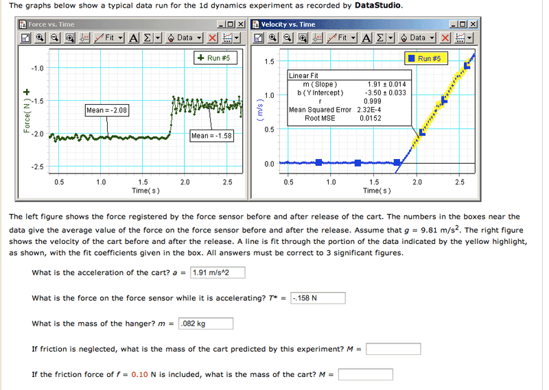

Hello everyone, I'm working on a physics postlab due tomorrow, and I'm just really skeptical that the answers I am getting so far are correct, I just feel like the problems are designed to "trick you" because of the values you are looking for are on the graph. could you guys please take a look at it and tell me how to do this particular page of the prelab correctly? The set up is a cart on a frictionless track that has a string tied to it which is also tied to some weight (the prelab calls it a hanger) that is hanging down and pulling on the cart. Attached a screen shot of the prelab
Thanks very much!
