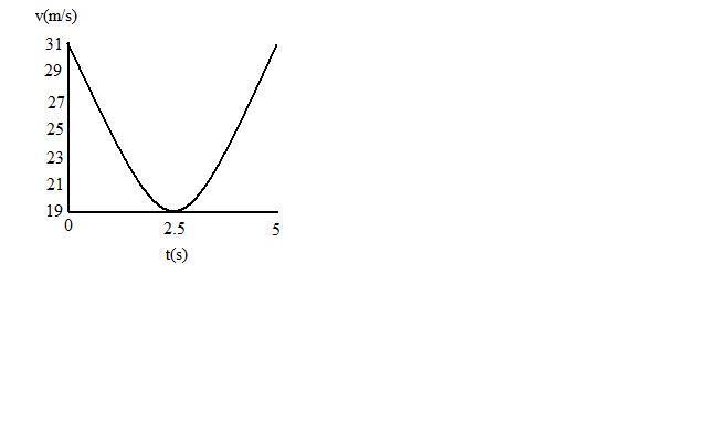

A golf ball is struck at ground level. The speed of the ball as a function of the time is attached, where t = 0 at the instant the ball is struck.
A) how far does the ball travel horizontally before returning to the ground level?
B) what is the max height above the ground level attained by the ball?
A)
x-x0 = (v0cos theta)t
B)
y-y0 = (v0sin theta)t - 1/2gt^2
I am stuck on this question. i don't know were to start. were not given theta or the final x position or the y value. I am sure the answer to this question is in the graph and i am just not reading it properly.
from the graph i have established that the ball is in the air for 5 sec. and that the initial velocity is 31m/s. however this isn't enough information to work out the questions. any help would be greatly appreciated

Welcome to PF!
tmay said:
B)
Hi tmay! Welcome to PF! :wink:
(have a theta: θ and try using the X2 tag just above the Reply box :wink:)
You know y - y0 and v0 and t, so θ = … ? :smile:
thankyou tiny - tim.
i now know how to get the answer.
