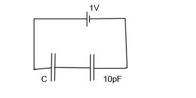

A parallel plate capacitor having two square plates each of side length 10mm has a plate separation of 100μm.
It is used to make a microphone where the sound waves cause the plate separation to change by +/- 10μm.
The microphone capacitor is connected in series with a constant 1 volt d.c. source of zero internal impedance and an amplifier with an input that can be regarded as a 10pF capacitor, the three components forming a complete circuit.
What is the peak to peak input voltage of the amplifier caused by the plate movement of +/-10μm ?
Assume the capacitor microphone has its gap filled with air.

Here's a circuit diagram just for reference

Hello Satellitelove,
Welcome to Physics Forums!
Your first course of action is to calculate the capacitance of the microphone itself, at its peak displacements. In other words, you need to find the capacitance of the microphone at two conditions: one where the separation is at 100 + 10 μm, and another where the separation is at 100 - 10 μm.
Secondly, you need to calculate the voltages across each of the components in the circuit (actually, you only really need the voltage across the 10 pF capacitor, but since all the voltages are related you might as well find them all). There are two concepts that will help you find this. You'll have to do everything below twice; once for each of your microphone capacitance values.
(1) Kirchhoff's circuit laws. The sum of all the voltages around a loop add up to zero.
(2) This second concept is a little more subtle. But I'm guessing you should assume the following: Before the components are connected together, the charge on each capacitor is zero. Which means the same thing as saying: Before the components are connected together, the voltage across the respective terminals of each capacitor is zero. Charge only builds up in the capacitors once the circuit is complete (including the 1 V DC source). Now here is the subtle part. Any current entering the microphone capacitor must also enter the amplifier capacitor. Since current is a measure of charge per unit time, it means that both capacitors have the same charge. If that doesn't make sense right away, think about it for awhile.
Using the above concepts, you should be able to generate two equations. So you have 2 equations and 2 unknowns. You should be able to solve for the voltages. Perform the above twice. Once for each microphone capacitance value. :wink:
