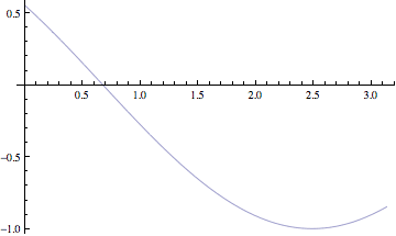

A body of mass 4[kgr] is moving along the x-axis while the following force is applied on it:
F= -3(x-6)
We know that at time t=0 the kinetic energy is K=2.16[J] and that its decreasing, that is, \frac{dK}{dt}<0.
The potential energy (with respect to the equilibrium point) at that same instant is: V=0.96[J]
When will this body return to its initial point (i.e. the position at t=0)?
2. The attempt at a solution
The initial position of the body with respect to the equilibrium point (x=6) is found from the P.E. expression, as the "spring" constant is k=3. So:
V=0.5kx^{2} \to x= \pm 0.8
Now, we find the position of the body with respect to time. The amplitude is found from energy conservation between the initial state and when the body is at a maximum distance from equilibrium (K=0), so that:
K(t=0)+V(t=0) = 0.5kA^{2} \to A=1.442
So,
x(t) = 1.442cos(\omega t + \phi) where \omega^{2}=k/m=0.75 and \phi is found from the initial position of the body: x= \pm 0.8
for the +0.8 we get after substitution: \phi = 56.3^{o}
for the -0.8 we get after substitution: \phi = 33.7^{o}
The data of \frac{dK}{dt} < 0 means that the body is drawing away from the initial position, so had it been in x=+0.8 then it moves to the right and had it been in in x=-0.8 then it moves to the left.
So I have everything I need to know about this oscillator. My question: What is the condition I need in order to answer what is required, i.e., the condition of the return of the body to its initial place?

x(0)=x(t) \to 1.442cos(56.3)=1.442cos((\sqrt{3}/2)t+56.3)
but this doesn't give me 2.27[sec] ...
How exactly did you calculate the time? Don't describe or imply what you did in words. Show the exact calculation.
I should convert this phase angle to radian \to 56.3^{o}=0.983[rad]
x(0)=x(t) \to 1.442cos(0.983)=1.442cos((\sqrt{3}/2)t+0.983) \to cos(0.983)=cos((\sqrt{3}/2)t+0.983) \to 0.983=\pm ((\sqrt{3}/2)t+0.983)
we ignore the "+" possibility because it will give the initial time, i.e. t=0. So:
0.983=-\frac{\sqrt{3}}{2}t-0.983 \to 1.966=-\frac{\sqrt{3}}{2}t \to t=\left | \frac{1.966*2}{-\sqrt{3}} \right |=2.27 [sec]
Well, it appears that I've made it :hurray:
by the way, is this solution what you meant or were you thinking of something else?
You're close, but you got the sign on the phase angle wrong. I plotted your expression, and you can see that it has the body moving back toward the equilibrium point so that dK/dt>0, not dK/dt<0 as given. And x(t=2.27) is clearly not equal to x(t=0).
The fact you arbitrarily had to throw in an absolute value to get the correct answer should have tipped you off as well that something was amiss.

The sign of the phase should be - .
Here is where you use the fact that KE is decreasing at t=0.
