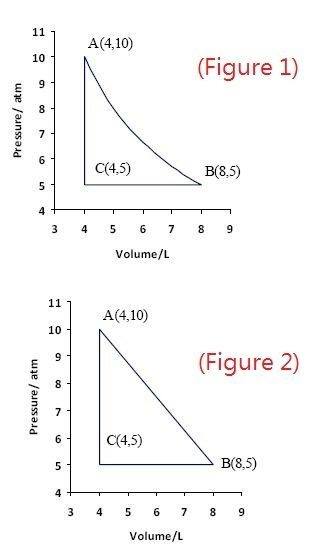

The question is to calculate: q, w, ∆U, ∆H, ∆S for each step(A to B, B to C, C to A)
I know how to calculate the values on figure 1, but, how to calculate A to B on figure 2?
For A to B on figure 1, it is isothermal process, therefore, I can easy to find out the answer, but I don't know what is the process for A to B on figure 2.
Can anyone tell me what the condition difference (A to B) between figure 1 and 2?

You don't need to know what kind of process is between A and B on picture 2. You simply calculate work by integrating, or simpler, by calculating surface under the AB line. It is easy to calculate, because you have one right angled triangle and one rectangle. (i will do approximation: 1atm=10^5 Pa, a 1L=1dm^3=10^-3 m^3)
Surface of triangle is:
S(t)=\frac{pV}{2}=\frac{5*10^{5}Pa*4*10^{-3}m^{3}}{2}=1000J
Surface of rectangle is:
S(r)=pV=10^{5}Pa*4*10^{-3}m=400J
So, total work is W=S(t)+S(r)=1400J
And now you can calculate everything else.
