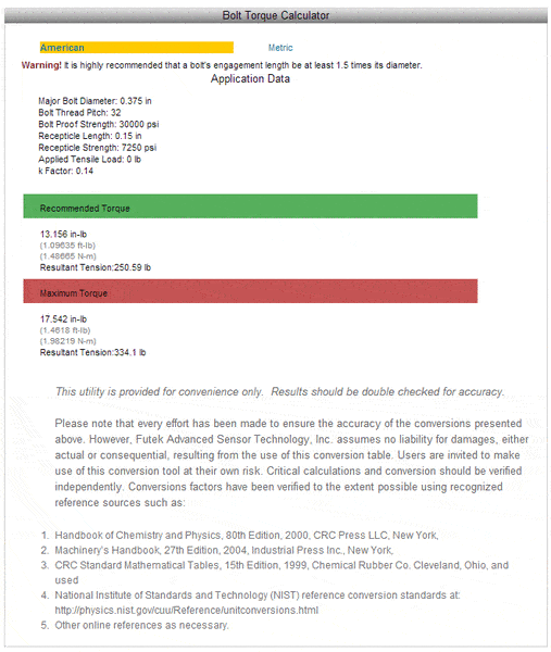

I am designing a mating male and female threaded interface, where the nut is much weaker than the male thread. I need to be able to calculate a few things:
A. The maximum force (as preload) required to reach the yield point of the nut material.
B. The torque required to achieve the above.
The thread is 3/8-32 UNEF. The male part is either nickel plated brass or zinc, and the female part is injection moulded ABS.
The length of engagement is 0.15".
I have found a few equations, but different sources list different methods. What I have also found is nobody cares how much torque it requires to strip a thread, as the more common goal is to calculate how much preload is required to yield the shank.
First, I put the numbers into the FUTEK bolt torque calculator:
17in-lb sounds like a reasonable figure for maximum torque and near what I'd expect.
It would be nice if FUTEK displayed the equations they derived their answers from, but they don't.
So, here are some of the methods and equations I have found:

But there is another equation, and completely different method, here.
I believe this link is calculating when the shank will fail, as the equation for F uses σT as opposed to SU.
Using 4:
If F = 560.425lb, Tin = 37.21in-lb
If F = 320.45lb, Tin = 21.28in-lb
The second number, 21.28in-lb seems to be within the range of what the FUTEK bolt torque calculator suggested. However, there are so many variables I am not certain of within these equations that I need to know more and if I am going wrong somewhere.
Please can anyone offer some advice, if not a definitive answer?
Many thanks.
In addition to the friction between the mating threads (which you accounted for), you need to account for the friction between the head of the bolt and whatever surface it is coming in contact with.
Ah, yes. The nut doesn't come into contact with a mating face, instead the mating faces are stationary inside the nut using a slip-ring mechanism. Thanks, I must take the friction and effective radius into account.
Is effective radius the mean diameter of the contact surfaces?
Thanks.

mc172, yes you treat it as a cantilever attached to the nut itself. Yes the threads will almost definitely not distribute the entire load evenly between them, mostly the firt two threads of your nut take the entire load, this is what I am assuming in my calcs.
Remember this will be the peak bending stress in the thread.
"σ_bending=My⁄I
with M = Ft/2; y = h/2 and I = bh^3/12"
By substituting we get σ_bending = (Ft/2)*(h/2)/bh^3/12
So σ_bending =(Fth/4)*(12/bh^3) hence σ_bending =3Ft⁄(bh^2) Hope you see this?
