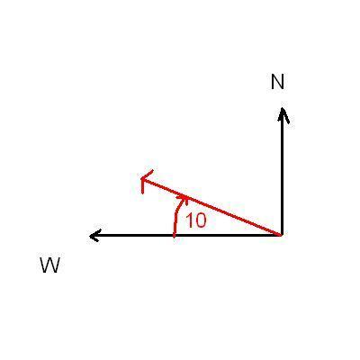

Two tugboats are pulling a large log, as shown in the following diagram. The log has a mass of 250 kg and is initially at rest. How far have the tugboats moved the log after 10 s?
http://imgur.com/GS7Y80x
c^2=a^2 + b^2 -2ab cosC
sin A/ a= sin B/ b= sin C/ c
Fg=G m1 m2/d^2
F=ma
d=1/2 a t^2
c^2=(400 N)^2 + (800 N)^2 -2(400 N)(800N)cos150
c=1164 N
sin A/ 400 N= sin150/ 1164 N
A=sin^-1 (400N sin150/1164N)
A=10 degrees
Here's where I'm having the most trouble, in my book it shows that you subtract the 20 degrees from angle A (10 degree angle). I don't understand this, how does it reflect the angle to which the net force is applied to?
So my answer for the first part is 1164 N [ N 10 W].

A is the angle between the 800 N force and the resultant force. The 800 N force is at 20°angle to the horizontal. So the angle of the resultant force with respect to the horizontal is 20° - A.

You determined the angle between the resultant and the 800 N force, and got A=10°. You need to give the direction of the resultant force. Which is (20-A), that is 10° to North with respect to West (I am not sure what [N 20 W] means :redface:. 20-A happens to be the same as A: 10°.
ehild
Sorry lol, let me clarify, they are meant to indicate direction; [north 10 degrees west] in reference to the log's original position.
Well, we do not indicate directions that way in my country (Hungary) . So does [N 20 W] mean the direction of the red arrow in my picture? If so, your answer is correct.
ehild

Yes, that is what I meant. I'm not sure if that's the correct way to reference it, it's just the only way I thought of describing it. Thank you so much for your help!

Then you have to change the angle so it is measured from the North.
It will be [N 80 W].
