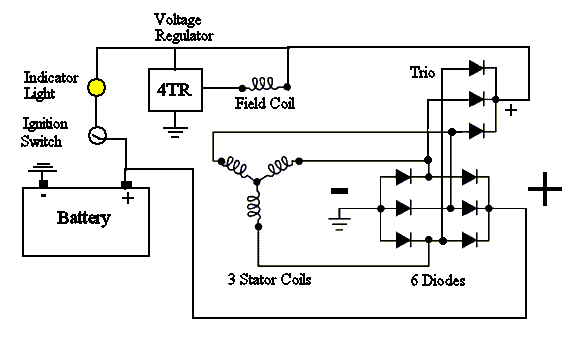

http://bob_skelly.home.comcast.net/~bob_skelly/alternator_conversion/wiring_alternator1.html
For the 1-wire, self-exciting design, the field windings are not energized via the ignition switch; instead, a special circuit is built into the internal voltage regulator that senses the rotation of the alternator’s rotor. The rotor must turn at sufficient speed to trip the circuit which excites the field windings and starts the charging process. This “cut-in” speed is affected by several things and is typically higher with certain high amperage alternators. Prior to reaching the cut-in speed, the charging system is not activated and the battery will be discharging. However, once the cut-in circuit is tripped, the alternator will charge at all speeds, even very low ones, until the alternator’s rotor comes to a complete stop. At that point, the circuit will shut off and wait for the process to be repeated.
Typically, after starting the engine, the engine must be revved above 1200-2000 RPM to turn-on the 1-wire alternator.

there's a pretty common failure that'll give one that symptom
The lamp alone does not pass enough current to "flash" the field.
So there's a resistor in parallel with the lamp, to deliver more current than the lamp alone would allow.
On old Ford trucks it's behind the dash on instrument cluster and virtually inaccessible.
When that resistor burns open the lamp still illuminates
and the alternator will commence charging if you rev it fast enough to bootstrap itself up with that feeble field current, on friend's old Ford truck a little more than 2000 engine RPM,.
But with a good resistor it ought to bootstrap itself at idle.
On a friend's truck we installed a "Field Flash" pushbutton.
A headlamp would probably have done same job.
old jim

Rpm is for rotor speed. Speed ratio is listed at 1.96. Engine idle is 900 rpm. [ref = shop manual]
So the alternator has a minimum speed of 1760 rpm.
Eyeballing that against the chart, it would be putting out ≈45 amps.
From my recollection, the alternator light never came on at night, with everything on, sitting at a stop light.
I don't know what automobiles normally consume, but when my alternator tension pulley fell off my last vehicle, I hooked up 3 x 50 watt solar panels, and drove home, which is about 12 miles. So with no auxiliaries, the car could not have been pulling much more than 10 amps, as that is about what the panels were capable of providing.
jim hardy said:
that's why I'm skeptical whether that alternator driven by radiator fan actually works.
Me too.
Matching the maximum output of my alternator to the output from the Wind Power app @ The Engineering Toolbox, I come up with a windmill diameter of 3.2 meters, to get 965 watts, @ 10 m/s (22 mph).
3.2 meters is about 10 feet.
hmmm... That's pretty big.
The light sees the difference between battery and alternator voltages.
That's why i prefer an ammeter, it'll show you when alternator can no longer keep up with demand, usually because of worn brushes.
A voltmeter can tell that also but requires closer attention,
Nice data, OM
Nice data, OM
It's been quite awhile since I've owned a vintage vehicle. I think the alternator generator light on my '61 beetle was always on, regardless of how steep the hill was I was driving down.
