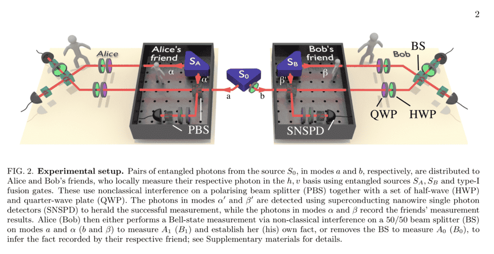

RUTA said:
First, this cannot possibly be a true Wigner’s friend experiment, since the friends are not screened off, i.e., they and their labs are interacting extensively with Wigner and Zeus’s labs, so decoherence will certainly render them “classical.” QM behavior does not follow from mere ignorance. Imagine for example that I scatter photons off electrons in a twin-slit experiment and use those photons to create “which-slit” information. If I merely hide the electron detector screen from my view and let my friend watch it, do you believe my friend will see an interference pattern? Of course not, but that’s exactly what they’re doing here.
I don't think this criticism of the experiment is warranted, from how I take the paper, at least. IMO it spawns from too literal an expectation for the Wigner's friend gedanken experiment aspect of it. It's more like a formal proof of concept, using single photons and a setup where everything can be kept coherent up until the final macroscopic measurement result of each trial is produced. I believe this is separate from any issues it has with assuming counterfactuals.
The criticism is very fair. The experiment is missing the essential point of Wigner's friend, i.e., the friend (measurement and recording device) must be screened off. Indeed, the entire collection of outcomes is compatible with a single, self-consistent (per QM) observer independent reality contrary to their claim. So, this is not even a proof of principle. See the two slides attached from Brukner and Renner's talks, respectively, at the APS March Meeting two weeks ago. Until someone can screen off a measurement, Wigner's friend has not been instantiated in fact or principle.
Again, this experiment is an instantiation of the Quantum Liar Experiment precisely as I explain in this Insight. Alice and Bob are doing measurements X and Y on an entangled system stemming from a particular form of psi (eigen function in Z). Alice and Bob's results in X and Y violate a Bell inequality implying no definite value for Z. But, without psi (in Z), the Bell results couldn't obtain. That's the experiment they should reference.
