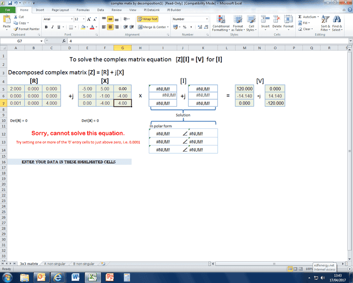

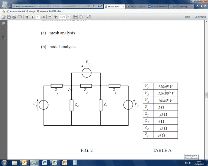

right so for question a I have the following.
loop 1 is 120=(2+j5)I1+ (j5)I2
loop 2 is -14.142+j14.142= (j5)I1 - (j1)I2 - (j4)I3
loop 3 is -j120 = -(j4)I2 + (4+ j4)I3
So my question is once I plug these into a complex matrix by decomposition excel program given to me by the university. This happens. Now I believe all my calcs are correct. so I've messaged the university. However once I get the three solutions (white boxes on photo) what do I do then. Because as far as I can tell that gives me i1, i2, and i3 . To find the total circuit current do I just add them all together.
rob1985
- 24
- 0
-14.142-j14.142= (j5)I1 - (j1)I2 - (j4)I3
yes sorry that was a typo. I've changed it in the spreadsheet but still no joy. so am I right in saying that once the spreadsheet is fixed I can add all three equations together to get the total current in the circuit
You may have to do as the spreadsheet suggests and "nudge" one or more of the zero entries away from zero.rob1985 said:-14.142-j14.142= (j5)I1 - (j1)I2 - (j4)I3
What does "the total current in the circuit" mean? There are three different sources and various currents flow in different places and different directions in the circuit. For mesh currents they often flow in opposite directions through a given path, so "summing" the total current is not a well defined operation.so am I right in saying that once the spreadsheet is fixed I can add all three equations together to get the total current in the circuit
What is it you're trying to accomplish by summing currents?
rob1985
- 24
- 0
I've got to determine what I is. Your right summing the currents won't work. I think I need to do loop 1 - loop 2 which is i1 - i2.
ive sorted the spread sheet out thank you. Am I right in saying that 3 three results in the polar form boxes are i1 , i2 and i3 respectively
That's right.rob1985 said:I've got to determine what I is. Your right summing the currents won't work. I think I need to do loop 1 - loop 2 which is i1 - i2.
Your results look good.rob1985 said:ive sorted the spread sheet out thank you. Am I right in saying that 3 three results in the polar form boxes are i1 , i2 and i3 respectively

The solution area on the spreadsheet has the currents in rectangular form:
If you are familiar with Excel you should be able to sum the requisite cells...
Edit: Also, be sure to pay attention to the exponential notation! Don't lose the power of ten in the values.
Edit 2: Be careful when finding the phase angle of the result. Check which quadrant the vector is in.

They're just numbers in the cells. They happen to be displayed using exponential notation. To add the contents of a couple of cells:rob1985 said:Unfortunately I am not familiar with excel and don't know how to add cells together with an exponential term in them.
1. select an empty cell somewhere where you'd like the result to end up and type an "="
2. select the first cell. The address of that cell should appear in the result cell.
3. Type "+".
4. select the second cell. It's address will appear in the destination cell.
5. Hit the <enter> key. The sum of the two cells will be displayed in the result cell.
That sounds right. If it's a problem, just convert the number to a plain format number before doing the math. "E+01" just means "x 101".Also on the calculator do I just type in 1.68 Exp 01. to give 4.5667 etc. I know it might sound like a daft question
Yes.And am I right in saying all the angles lie in the 4th quarter.

So part b) find I by nodal analysis
So I have the following
V1/Z1 - V20/Z1 - V20/Z4 + V3/Z5 - V20/Z5 + V2/Z3 - V20/Z3 + V3/Z3 = 0
(V1 - V20)/Z1 + -V20/Z4 + (-V20-V3)/Z5 - V2 - (V20 - V3)/Z3 = 0
(V1 - V20)/Z1 - V20/Z4 + (V3 - V20)/Z5 + (V2 - V20 + V3/Z3 = 0
-V20 ( 1/Z1 + 1/Z4 + 1/Z5 + 1/Z3) + ( V1/Z1 + V3/Z5 + V2/Z3 +V3/Z3) = 0
can this equation be simplified anymore, does anyone know

Hi Rob1985
I too am working on this and just can't seem to get it right.
My equation is similar to yours.
I have used different terminology but if I use your terminology I have:
(V1-V20 / Z1) - (V20/Z4) - (V30/Z5) + ((V2+V30)/Z3)
Obviously wrong as does not get the answer from mesh analysis.
Just can't see where...
The Electrician
- 1,402
- 210
WeeChumlee said:Hi Rob1985
You need to be careful with your notation. Read post #46 in this thread.
You need more parentheses, for example (V1-V20 / Z1) should be ((V1-V20) / Z1)
Also, you have (V1-V20 / Z1) - (V20/Z4) - (V30/Z5) + ((V2+V30)/Z3) which is not an equation, but just an expression. You must equate expressions to zero, and of course you will need more than one equation.

Hi Electrician
Yes indeed, that was me being lazy and not putting all parentheses in, silly of me.
What I have is this:
((V1-V20) / Z1) - (V20/Z4) - (V30/Z5) + ((V2+V30)/Z3) = 0

Darn:
Was of course
V20-V30 = 14.14+j14.14
Was of course
WeeChumlee
- 9
- 0
Carrying on from this as I am getting nowhere..
V30 = V20 - V3
((V1-V20) / Z1) - (V20/Z4) - ((V20-V3)/Z5) + ((V2+(V20-V3))/Z3) = 0
When I put the values into get V20 and divide that by Z4 I get 8.78 - j16.59
Not the answer I got for the mesh analysis which was -9.1 + j17.3
If someone could point me in the right direction I would be most grateful.

WeeChumlee said:Carrying on from this as I am getting nowhere..
V30 = V20 - V3
If I solve these two equations:
((V1-V20) / Z1) - (V20/Z4) - (V30/Z5) + ((V2-V30)/Z3) = 0
V30 = V20 - V3
with the sign of V2+V30 changed (in red above) to V2-V30, I get the correct answer for V20 and V30. And, after dividing by Z4 I get the correct current.
But with the + sign you have I don't get what you got for the current I even with the incorrect values it gives for V20 and V30; check your solution method.

Thanks Electrician
Yes, I totally see that sign change, that was an error of mine.
Funny thing is that I had it right the first time but got the wrong answer so in trying to get the right answer that was a change I made.
I had used an online calculator to try and get the answer, I must have made a syntax error or something.
Just did it all on paper right now and voila, answer is as expected.
Probably serves me right for trying to cut corners.
At least I know my Math is still OK. :)

Hi I am doing part b) and have made a basic error somewhere and can't for the life of me see where and am hoping someone can Point me in the right direction. I am getting an I that does not match my mesh I ( -9.2+j17.3) I have narrowed it down to the V3 I'm using of 14.14+j14.14 as part as when I do (v1/z1+v3/z5+v2/z3+v3/z3) I get 60+j37.07
If I change it to 14.14-j14.14 I get the correct answer but I can't see where I do that.
You'll have to present your work in more detail. What you've written above does not contain a correct node equation (or any equation, since an equation requires that a relationship be expressed, usually of the form <something> = <something else>).Student12345 said:Hi I am doing part b) and have made a basic error somewhere and can't for the life of me see where and am hoping someone can Point me in the right direction. I am getting an I that does not match my mesh I ( -9.2+j17.3) I have narrowed it down to the V3 I'm using of 14.14+j14.14 as part as when I do (v1/z1+v3/z5+v2/z3+v3/z3) I get 60+j37.07
Student12345
- 10
- 0
gneill said:You'll have to present your work in more detail. What you've written above does not contain a correct node equation (or any equation, since an equation requires that a relationship be expressed, usually of the form <something> = <something else>).
Sorry I'm trying not to waffle on I obviously didn't put enough in. I have the following equation which I believe is correct
-v20(1/z1+1/z4+1/z5+1/z3)+(v1/z1+v3/z5+v2/z3+v3/z3)=0
When I input my values of
-v20((1/2)+(1/-j5)+(1/j4)+(1/4))+((120/2)+((14.14+j14.14)/j4)+(j120/4)+((14.14+j14.14)/4)=0
I get -v20(0.75+j0.05)+(60+j37.07)=0
From working backward from my mesh I result I know I need the second part to be (67.7+j30) so I know I'm close but I just can't see where I've gone wrong
Okay. You're node equation looks fine, and the version with the values plugged in looks okay too. So the problem must lie in the final reduction.
When I work from your
I end up with v20 = 86.376 + j45.758
So it looks like you'll need to take a closer look at your complex arithmetic.
Student12345
- 10
- 0
gneill said:Okay. You're node equation looks fine, and the version with the values plugged in looks okay too. So the problem must lie in the final reduction.
Ok thanks for your help I have had another look and spotted a couple of mistakes -v20 somehow became v20=
