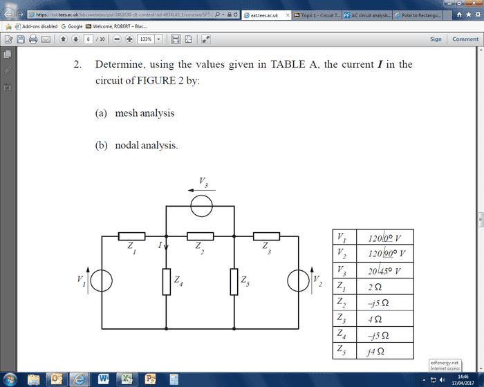

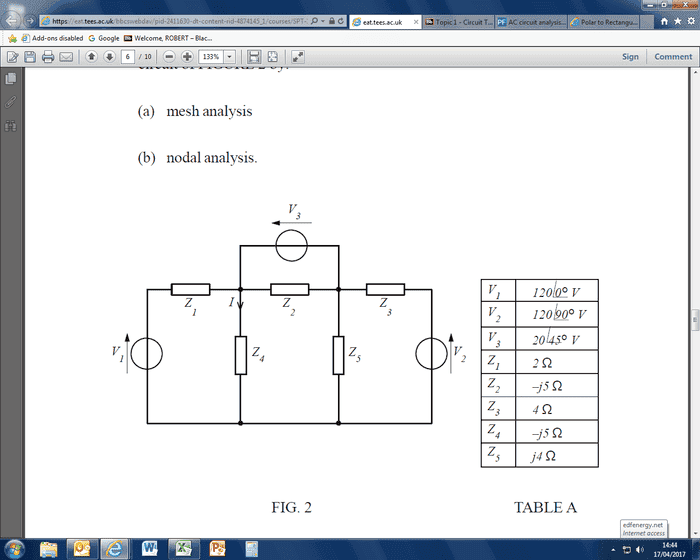

I have redrawn the polarity of impedances and voltage sources in the attached image.
Mesh 1 -
v1 - (z1)(I1) - (z4)(i1 - i2) = 0
v1 - (2)(i1) + (5j)(i1) -(5j)i2 = 0
120 = (2 - 5j)i1 + (5j)i2
Mesh 2
-v3 - (z5)(i2 - i3) - (z4)(i2 - i1)
-v3 -(4j)(i2) +(4j)(i3) +(5j)(i2) - (5j)(i1)
-v3 = +(4j)(i2) - (4j)(i3) -(5j)(i2) +(5j)(i1)
-14.14 - 14.14j = + (5j)(i1) - (1j)(i2) -(4j)i3
Mesh 3 -
-v2 - (z5)(i3 - i2) - (z3(i3)
-v2 -(4j)(i3) +(4j)(i2) - (4j)(i3)
-120j = -(4j)(i2) + (4 +4j)(i3)the answers are slightly diffrerent from last time but still no joy in the spreadsheet

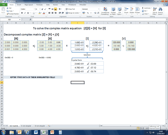

Thanks for the help, for some reason. the spreadsheet given to me just is not calculating the mesh currents. i have tried an internet calculator and it calculates it just fine.

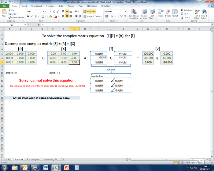

Hi gneill, I am having a little trouble with the matrix spread sheet when entering my values. I have read through this forum and notice that my answers are the same as that in post #31 and #33 which you say are correct. But when i put these figures into the matrix spread sheet it is incorrect. I noticed in post #73 that you suggested in loop 2 the -jI2 should in fact be a jI2. my calculations for loops two are as below;
-(14.142-j14.142)+(-j5)I1-(j4+(-j5)I2+j4I3
(-14.142-j14.142)=j5I2-jI2-j4I3
Thanks
  • #99
HI Hndstudent. As far as I can see the values that you show entered in the spreadsheet look fine. There should be no reason why it cannot solve it assuming that the spreadsheet itself is properly coded.
I see that the spreadsheet displays det(R) = 0 and det(X) = 0. If the spreadsheet is rejecting the problem because of zero determinants here, then it is incorrect. For while those determinants are indeed zero, it is more important that det(R + jX) be nonzero, which it is.
  • #100
I gneill, the spreadsheet is off the Universities Blackboard. Would you recommend that I contact them and inform them that there is a problem with it? Or is there something that i can do to fix it?
Thanks

v1-z1I1-z4(I1-I2)=0
if z1=2 , z4=-j5 and v1=120
then 120=(2+j5)I1-j5I2 (is this not correct?)
as before I had 120=(2-j5)I1-j5I2.
Thanks
  • #103
Hndstudent said:
v1-z1I1-z4(I1-I2)=0
##120 - 2 I_1 - (-j5)(I_1 - I_2) = 0 ##
##120 - (2 - j 5) I_1 - j5 I_2 = 0 ##
##120 = (2 - j5) I_1 + j5 I_2 ##

Cheers gneil. The university confirmed what you said about the spread sheet and it eventually worked :)
however, for my next problem on 2b, I have factorised and multiplied by conjugates to end up with the following;

Hi Folks,
Sorry to revive an old thread but I am on the same unit and the notes are not helping me much!
What I have so far is -
Mesh 1
V1-(Vz1)-(Vz4)=0
V1-(I1Z1)-((I1-I2)Z4)=0
V1-I1(Z1-Z4)+(I2Z4)=0
120-I1(2+j5)-I2(-j5)=0
Mesh 2
-V3-Vz5+Vz4=0
-V3-Z5(I2-I3)+Z4(I2-I1)=0
-V3-(Z5I2)+(Z5I3)+(Z4I2)-(Z4I1)=0
-V3-(j4I2)+(j4I3)+(j5I2)-(j5I1)=0
-V3-(j1I2)+(j4I3)-(J5I1)=0
Mesh 3
-(Vz3)-V2-(Vz5)=0
-(I3Z3)-V2-(I3-I2)Z5=0
-(I3Z3)-V2-(Z5I3)+(Z5I2)=0
-I3(Z3-Z5)-V2+Z5I2=0 (Z5 term moved to the left end in next step)
(I2j4)-I3(4-j4)-V2=0
When I put the above into my spreadsheet (same excel one as posted earlier) I am not getting the answer I expected. I have done the nodal analysis (next question) but this doesn't fit with that answer.
Can anyone spot any obvious mistakes in my loop walks?
Thanks in advance

Mesh 1
V1-(Vz1)-(Vz4)=0
V1-I1(Z1-Z4)+(I2Z4)=0##~~~~~~~##← Sign issue with the I1 term: Why is Z4 negative?
Mesh 2
-V3-Vz5+Vz4=0##~~~~~~~~## ← Sign issue with the Vz4 term: Why is Vz5 negative and Vz4 positive?
-V3-Z5(I2-I3)+Z4(I2-I1)=0##~~~~~~~##← Sign issue with the Z4 term
Mesh 3
-(Vz3)-V2-(Vz5)=0
Thanks in advance
Mac
See the red flagged lines.

  • #117
What you need to consider when you "walk" over a component is whether or not your walk is in the same direction as the current that pertains to the term you are writing.
Before you took your KVL walk you assigned current directions for the mesh currents. In this case they are all clockwise. When you walk over a component in the same direction as a current you will have a potential drop due to that current. When you walk against a current flow you have a potential rise.
Consider mesh 2. The mesh current is clockwise and if you walk the loop clockwise all the resistors encountered will show a potential drop for that mesh current. This includes Z4. So you must find the drops: I2(Z4 + Z5). The border components of the mesh will have the currents of the bordering meshes flowing in the opposite direction to the mesh 2 current and your "walk" will be against the directions of those currents. So for mesh 2 you will see potential rises of I1Z4 and I3Z5.
When in doubt, on the schematic sketch in the potential changes for all the assumed currents. That should help when writing out the equations:
By inspection then:
+(I1)(Z4) - (I2)(Z4 + Z5) + (I3)(Z5) = 0

does I = -6.84008+j17.3988?
for nodal way
  • #120
Sorry made a mistake in calculation so i have :
V20(0.75+J0.05)=67071+J30
V20=91.6872+J33.875
V20/Z4=I
I=91.6872+J33.875/-J5
I=-6.7775+J18.3374
