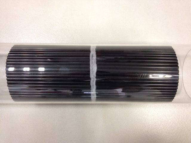

Ok Sirs,
Wonderful...
The restriction covering all internal section of the pipe or tube, it was made to decrease the velocity and create a steady and laminar flow from the fan to the rest of the ring bench in the pipe/tube section.
Yes, physically, I thought the restriction or constriction was a kind of media in the system, and, as it create upstream and downstream a different pressure, I thought I could measuring this difference to deduce air velocity of the rotating anemometer, and verify the truth air speed.
I must gave you a schematic, but I need to draw it on my computer.

Please tell us more details about the geometry of the honeycomb. This is the only way we can have a chance of analyzing in advance the pressure drop - flow rate relationship for the honeycomb (i.e., the permeability k of the honeycomb). But note that, if the geometry is too complicated, you will have to do experiments to calibrate the permeability k. Then you can use that value for other tests. That's what we do when we characterize the flow properties of geological rocks.
Chet

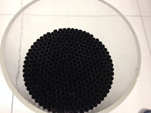

The honeycomb is cylindric, internal diameter : 100 mm is made by many plastic straws (for cocktails) with an internal diameter of 4 mm there are in the tube, the lengh of the two honeycomb with the large fiber filter is 26,5 mm, the large fiber filter is a white synthetic cotton (used for cleaned or filtering aquarium) compressed by the two honeycomb the thickness is 5 mm (average) ( I upload two photos if you want).
Yes probably I must experiment...

The permeability k of those honeycombs should be really easy to estimate. If the straws are laid out in an equilateral triangular array, what is the total cross sectional area that can be assigned to each straw?
If you neglect the flow air flow down the cusps between the straws, then you have a set of circular cylinders in parallel. Do you know the Hagen Poiseulle law for average flow velocity through a circular cylinder as a function of the pressure drop (in terms of the diameter and the viscosity of the fluid)?

The side of each equilateral triangle in the array is D, and each triangle contains half a cylinder of diameter D. So there are two triangles of side D per cylinder of diameter D. So, what is the ratio of the cylinder area to the area of the two triangles? (This is also the ratio of the open area of the cylinders to the total cross sectional area of the torus).
Chet
You should research existing wind tunnel designs: those straws look too long to me and what's the point of having the fibre screen between 2 sets of straws?
To MrAnchovy:
Yes this bench is home made and currently existing.
Because of the too high air speed of the fan at it minimum voltage, I looked for having around 0,2 m/s at the minimum voltage of the fan, I had the idea to put this filter, this screen, between the two sets of straws only for this reason.
Yes probably the straws are too long, but it was difficult to cut them perfectly to another length, then I thought it was better for having the most laminar flow after this honeycomb...probably a mistake.

The side of the equilateral triangle joining the centers of three straws in contact within the triangular array is equal to the diameter of a straw D. This equilateral triangle contains just half a straw of diameter D. So there are two triangles per straw. The area of one triangle is ##\frac{D^2}{4}\sqrt{3}##, so the area of two triangles is ##\frac{D^2}{2}\sqrt{3}##. The flow area of a straw is ##\pi\frac{D^2}{4}##. So the ratio of the flow area to the overall cross sectional area is ##\frac{\pi}{2\sqrt{3}}=0.907##.
For laminar flow in a single tube, the average velocity down the tube is given by:
$$\bar{v}=\frac{D^2}{32\mu}\frac{Δp}{L}$$
The superficial velocity v (based on the total cross section) is related to the average velocity down the tube by:
$$v=0.907\bar{v}$$
So, in terms of the superficial velocity, we obtain:
$$v=0.907\frac{D^2}{32\mu}\frac{Δp}{L}$$
From this, it follows that the permeability of the honeycomb k is related to the diameter of a straw D by:
$$k=0.907\frac{D^2}{32}$$

Could you saw it and tell me if it is ok ?
I have a doubt about the theoretical results it seem to be strange, but I have no experience in this kind of physic.
Nice week end, and thank's.
As best I can tell, your analysis is not correct. I derived the equation for k for a single honeycomb in post #24. For two honeycombs in series, K = k/2. You then use the equation:
$$Q =\frac{K}{μ}\frac{ΔP}{L}A=\frac{k}{μ}\frac{ΔP}{2L}A$$
where L is the length of one honeycomb and A is the open cross sectional area of your tube.
Chet
Chet,
I'm confused of course.
I was proud of my calculation.
I ready to review them and come back here again for correction or not.
This wind tunnel is very long...
How can I thank you for your patience?
