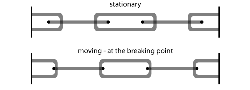

The distance between the ships stays constant in the launch frame. But the atoms of the string are contracting in the launch frame. At some point they cannot span the constant distance anymore.
You can replace the string with a chain, and consider the individual chain links as rigid elements, which are all contracting as the chain accelerates:

Yes, that is reasonable. Then the condition for snapping is that the distance between the ships is greater than the length of the string. In the ships frame that condition is met because the length stays the same and the distance increases. In the launch frame that condition is met because the distance stays the same and the length contracts.
