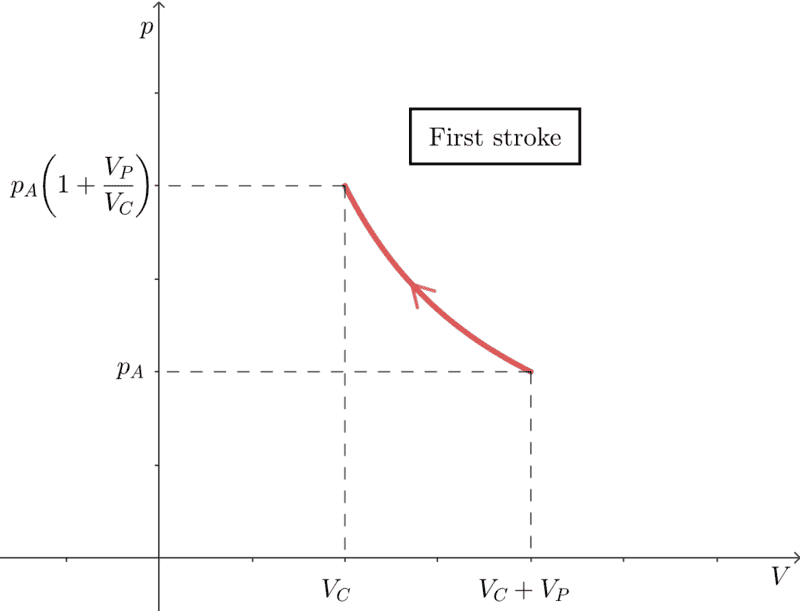

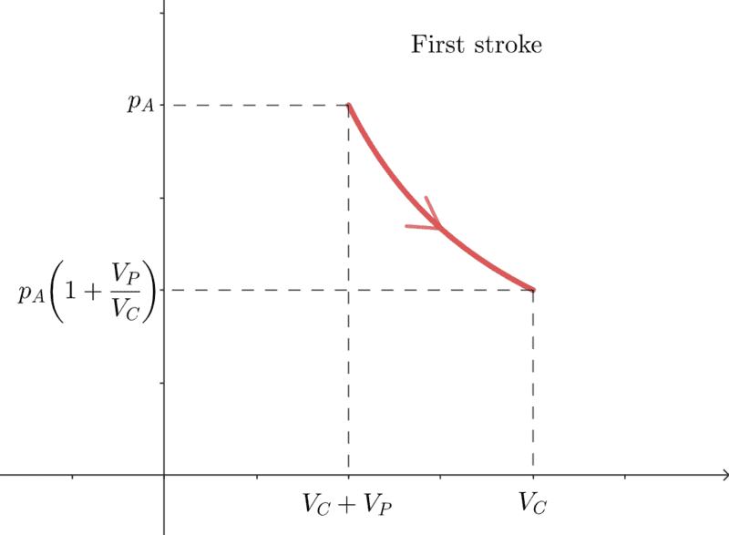

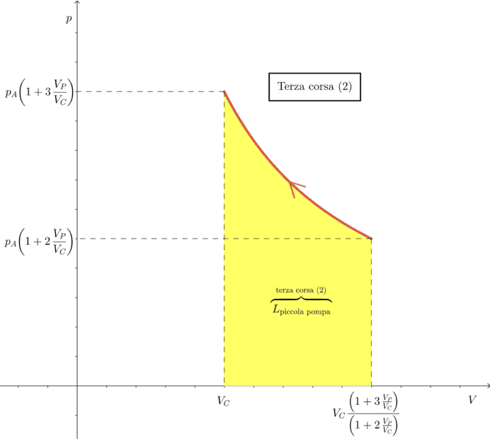

Is the following graph (first stroke) correct? Or is the arrow pointing in the opposite direction?

Compression generally means a decrease in volume of the system.
The isothermal work done on an ideal gas is given by ##W = - \int PdV = - nRT\log\frac{V_f}{V_i} = nRT\log\frac{V_i}{V_f}## and this formula holds for compression (##V_f < V_i##) and for expansion (##V_f > V_i##). For compression, the formula yields a positive work done on the gas. For expansion, the same formula yields a negative work done on the gas.

  • #71
Opposite direction
  • #72
TSny said:
Opposite direction
So it is an expansion, not a compression... Right?

I just can't understand this and I am very much in distress and confusion. If it were directed in the opposite way, the initial volume would be less than the final volume, so it would be an expansion, not a compression... No?
  • #75
Oh, I think I might see the confusion now.
If you are just about to push down on the handle to transfer air into the container, then the air that is initially inside the pump with volume ##V_P## ends up inside the container with volume ##V_C##. So the volume of that air expands. But, we are not taking our system to be the air initially in the pump. The system is the air inside the pump plus the air inside the container. This system has an initial volume equal to ##V_P + V_C## and a final volume ##V_C##. So, this system undergoes compression and the pressure of the system increases. Positive work is done on this system by the piston.
  • #76
I just noticed that your volumes ##V_C## and ##V_C + V_P## should be interchanged on the horizontal axis of your graph.

  • #78
Thanks, I got it.
  • #79
If the initial volume is ##V_P +V_C## and the initial pressure is ##p_{atm}##, why must the two volumes be interchanged on the horizontal axis?
  • #80
I understand now. I swapped the values, the volumes and pressures I entered as lower, are actually higher than the latter. I am an idiot.
Edit. Actually, I did not understand how to make the graph. Maybe the latter is just wrong. I can't get the corresponding values on the axes of the Clapeyron diagram. How should this drawing be done?
In your P-V diagram, you just need to switch the positions of ##V_C## and ##V_C+V_P## on the horizontal axis and switch the two pressure values on the vertical axis. Then, you can see that the direction of the process on the diagram is from lower right to upper left. The pressure increases as the volume decreases.

Is the following graph correct?
  • #83
Yes, that's correct.

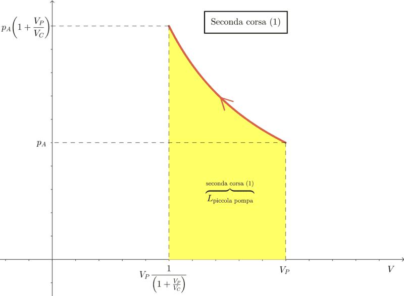

Ok. So, in light of that, heat is absorbed by the system of the air and is positive, right? Thank you so much.
  • #86

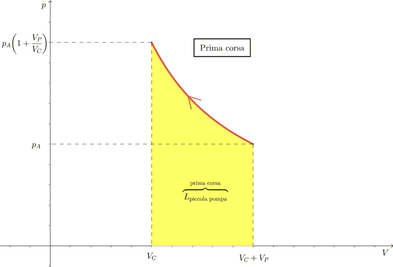

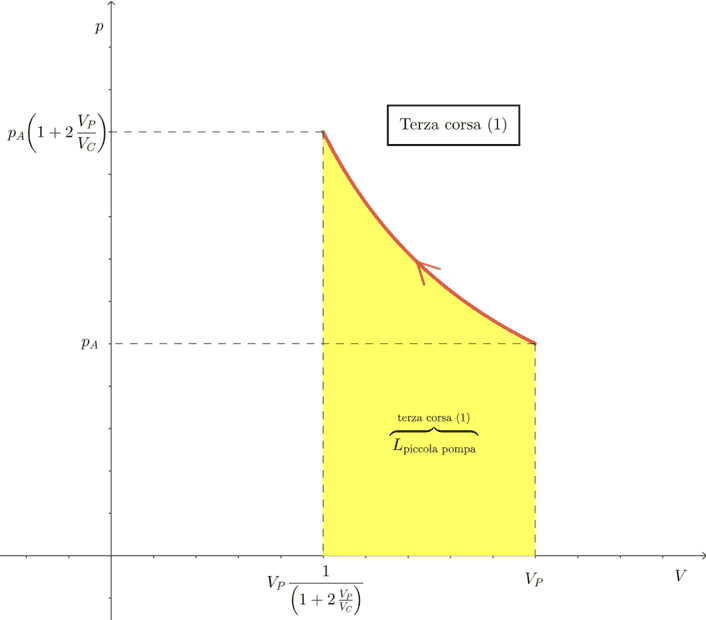

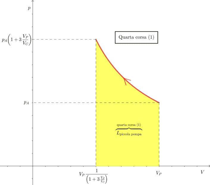

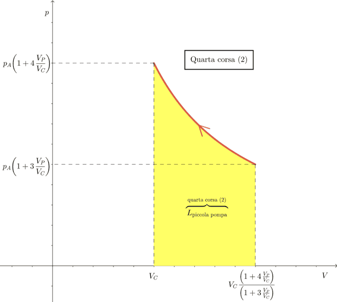

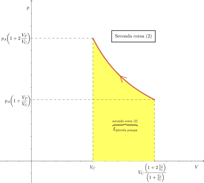

In addition, I made these diagrams. Don't mind the Italian writing (unfortunately, carelessly, I forgot to translate from my native language to English), they are in ascending order from the first to the fourth stroke of the small pump, and finally there is that of the large pump. The part in yellow is the work done by each stroke. How do they look to you? Could anything be added?
