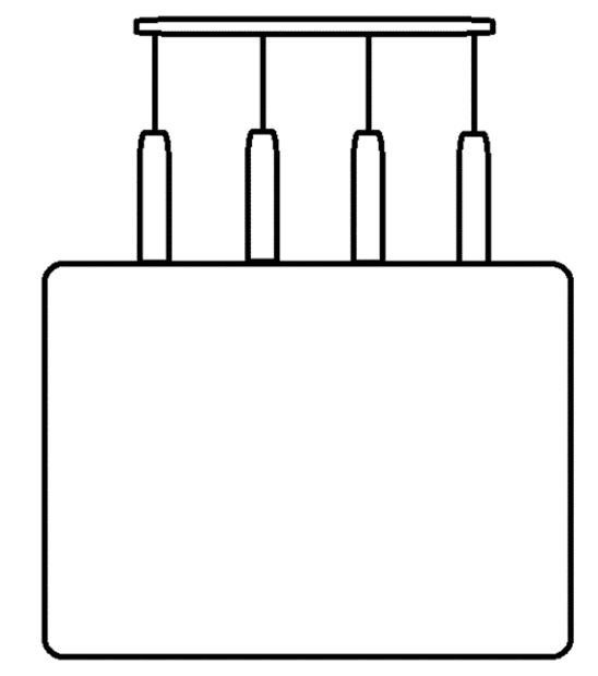

Is My Calculation for Bicycle Pump Pressure Incorrect?

Is the following graph (first stroke) correct? Or is the arrow pointing in the opposite direction?
  • P-V diagram of the first stroke of a bicycle pump: a red curve with an arrow falls from pressure p_A at volume V_C + V_P down to pressure p_A(1 + V_P/V_C) at volume V_C, with dashed guide lines to both axes.

Is the following graph correct?
  • p-V graph of a pump stroke: a red curve falls from (V_C, p_A(1 + V_P/V_C)) to (V_C + V_P, p_A), arrow pointing left, labelled First stroke; dashed guide lines mark both endpoints.
Yes, that's correct.

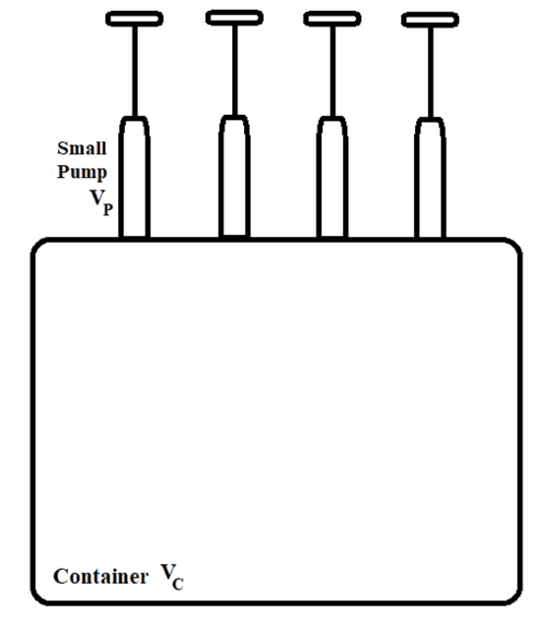

In addition, I made these diagrams. Don't mind the Italian writing (unfortunately, carelessly, I forgot to translate from my native language to English), they are in ascending order from the first to the fourth stroke of the small pump, and finally there is that of the large pump. The part in yellow is the work done by each stroke. How do they look to you? Could anything be added?
  • P-V diagram of a pump's first stroke: a decreasing curve from p_A(1 + V_P/V_C) at V_C down to p_A at V_C + V_P, with the area under it shaded yellow and labelled Prima corsa.

  • P-V diagram of the second stroke (1) of a small pump: a decreasing curve from p_A(1 + V_P/V_C) at V = 1 down to p_A at V_P, with the area under it shaded yellow and labelled L piccola pompa.
  • p-V diagram of a second stroke (2) of a pump: a decreasing curve from (V_C, p_A(1 + 2V_P/V_C)) to (V_C(1 + 2V_P/V_C)/(1 + V_P/V_C), p_A(1 + V_P/V_C)), with the area under it shaded yellow and labelled L piccola pompa.
  • p-V diagram of a pump stroke: a red decreasing curve from (1, p_A(1 + 2V_P/V_C)) to (V_P, p_A), with the area under it shaded yellow and labelled terza corsa (1), L piccola pompa.
  • p-V diagram of the third stroke of a small pump: a decreasing red curve from (V_C, p_A(1+3V_P/V_C)) to (V_C(1+3V_P/V_C)/(1+2V_P/V_C), p_A(1+2V_P/V_C)), with the area under it shaded yellow and labelled terza corsa (2) L piccola pompa.
  • P-V diagram of a pump cycle with a red curve falling from upper left to lower right, shaded yellow below it; labelled Quarta corsa (1), with dashed guides to p_A(1 + 3V_P/V_C), p_A, and volumes 1/(1 + 3V_P/V_C) and V_P.
  • P-V diagram of the fourth stroke (2) of a small pump: a red curve falls from p_A(1 + 4V_P/V_C) at V_C to p_A(1 + 3V_P/V_C) at V_C(1 + 4V_P/V_C)/(1 + 3V_P/V_C), with the area under it shaded yellow.
  • Pressure-volume graph of a single pump stroke, p against V, with a decreasing red isothermal curve from (V_C, p_A(1+4V_P/V_C)) to (V_C+4V_P, p_A), shaded yellow beneath it and labelled L_grande pompa; label reads Unica corsa.
