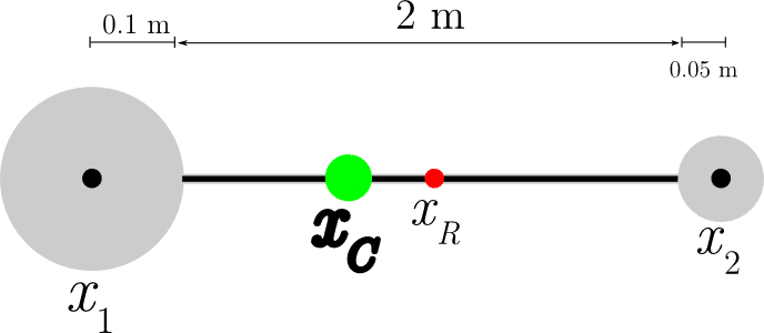

A cylindrical rod has a mass of 10 kg and a length of 2 m. At either end of the rod are fitted a sphere each - the one on the left has a mass of 50 kg and a diameter of 0.2 m while that on the right has a mass of 20 kg and a diameter of 0.1 m. Calculate the c.g. of the combination
Answer (in textbook) ##\boxed{\color {red} {x_C = 73 \;\text{cm}}}\; \text{from the center of the larger sphere}##
Center of gravity in one dimension : ##x_C = \frac{\Sigma_i m_i x_i}{\Sigma m_i}##
I begin by drawing the problem. Let the center of the bigger sphere on the left by the origin for the system.
Calculating ##x_C = \frac{10 \times 1.1 + 20 \times 2.15}{50+20+10} = \frac{54}{80} = 0.675\; \text{m} \;= \boxed{67.5 \; \text{cm}}\;##.
Problem is, doesn't match the answer in the text (given above).
Is my calculation alright?
Yes
gleem said:
Yes
Thank you. Fortunately I am in contact with the author of the book, who needs to be written to.
