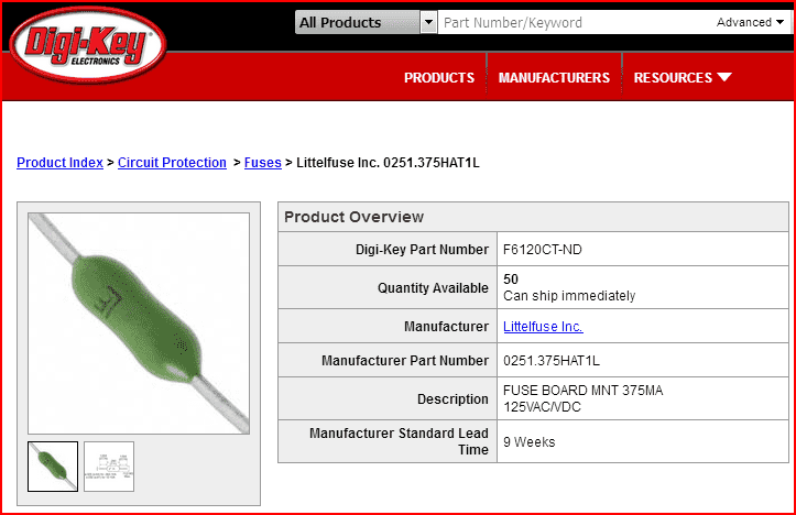

I found that in another hand-written note on the schematic -- looks to be 375mA

Are you sure you aren't using current mode on your DVM? With such a small value fuse, if you are trying to measure current instead of voltage, your DVM will short out the circuit and blow the 375mA fuse.
