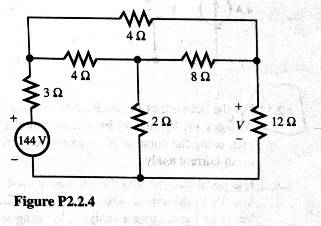

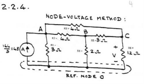

Ok folks :smile: I am not sure where to go from here. Someone suggested changing the 144V to its Thevenin equivalent, which I have done below. I know that I am supposed to apply KCL at each node A,B, and C. And then I represent each current in terms of voltages. Now I am a little confused as to how to proceed.
I am trying got convince myself that R1, R2, and R3 are in parallel because their leads are all connected, but I am not sure yet. The voltage drop across R1 is definitely just VA since I can pass from A across the resistor and directly to ground. But for R2 and R3, I feel like the voltages at B and C need to be considered.
Any thoughts?
I think you meant to say that you've changed the voltage supply and its series resistance to its Norton equivalent.
Also, one leg in common does not a parallel connection make; R1, R2, and R3 are not in parallel.
With the network as shown in your second diagram, you are in a position to write the node voltage equations by inspection.
So they are not in parallel because they do not share the same voltage, correct?
I think I have it now:
Node A:
[itex]48 - V_A/3 - (V_B - V_A)/4 - (V_C - V_A)/4 = 0[/itex]
Node B:
[itex](V_B - V_A)/4 - (V_C - V_B)/3 - V_B/2 = 0[/itex]
Node C:
[itex]-V_C/12 + (V_C - V_B)/3 + (V_C - V_A)/4 = 0[/itex]
Now I need to move forward to the mesh analysis.
For components to be in parallel, both ends of each need to be directly connected to each other.
