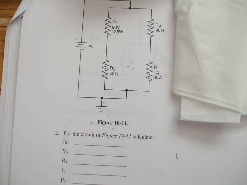

- One participant expresses uncertainty about how to start solving for unknowns in a circuit problem.
- Another participant suggests writing down Ohm's law, power equations, and the formulas for adding resistors in series and parallel as a foundational step.
- A different participant advises analyzing the given resistors, indicating that R1 and R3 are in series and R2 and R4 are also in series, and recommends using power formulas to find resistances.
- Further, it is proposed that to find the total resistance, one must first calculate the series resistance and then combine those subtotals in parallel to find the total resistance.
- A mathematical expression for equivalent resistance (Req) is provided, along with formulas for total current (Itot) and power (Pt), indicating relationships between the currents in different arms of the circuit.
