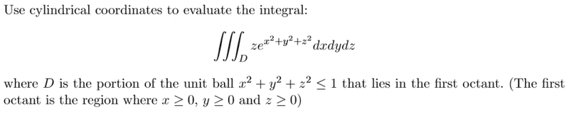

x^2+y^2 = r^2
I think it is asking me to find the volume of the sphere, which is in the first octant (1/8 of the sphere)
So I set
0<= z<= √1-r2
0 <= r <= 1
0<=θ<=π/2
Hi, remember that if you want the volume of ##D## you must calculate ##\int\int\int_{D}1dxdydz## where ##f(x,y,z)=1## ...
I think the question wants me to use the du dv
no because ##f(x,y,z)\not=1## ...
What I want to say is that your coordinates are ok ## x=r\cos{\theta}, y=r\sin{\theta}, z=z ## but evaluating the integral you don't have the volume of the sphere (as you said ...) but simply a result that is the evaluation of the integral ...
So simply put, do I just plug in the limits:
0<= z<= √1-r2
0 <= r <= 1
0<=θ<=π/2
and into the zex2+y2+z2
then the integral will be something like ∫∫∫∫ z dz r dr dθ

Your integrand will be ##ze^{x^2+y^2+z^2}## in cylindrical coordinates with ##dV = r~dz~dr~d\theta##.
Okay but where does z goes (it was before ##e^{x^2+y^2+z^2}##)
?. Right where I have it.
I rewrite my thought
Originally I have limits:
0<= z<= √1-r2
0 <= r <= 1
0<=θ<=π/2
Then I use them on ∫ ∫ ∫
replace also ex^2+y^2+z^2 with er2+z2
Then I have ∫ ∫ ∫ z er2+z2 r dz dr dθ
