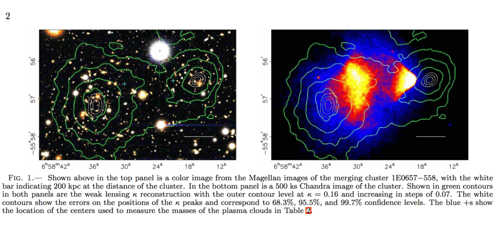

For her discovery, Vera should have received more.
https://www.nasa.gov/vision/universe/starsgalaxies/dark_matter_proven.html
A bit of digging for query (1) suggests that x-ray photons, hugely lensed by a galaxy cluster, from a massive, irregular "halo" cloud are what the obsrvers are defining as "proof" of DM.
Hot gas away from the parent galaxies, emitting x-ray photons. This is an indirect photonic measurement attributed as evidence for DM.
These pictures suggest the photonic source gas (attributed to DM) completely envelope a vast galactic cluster, including the space between the galaxies. Perhaps this is Rubin's "missing mass"?
The link present a model image of a sphere of putative DM - gravitationally bound to the cluster. my second query (2) remains: Is DM sensitive to the gravity of a black hole?
Offered in another way: Why would black holes discriminate against DM?
