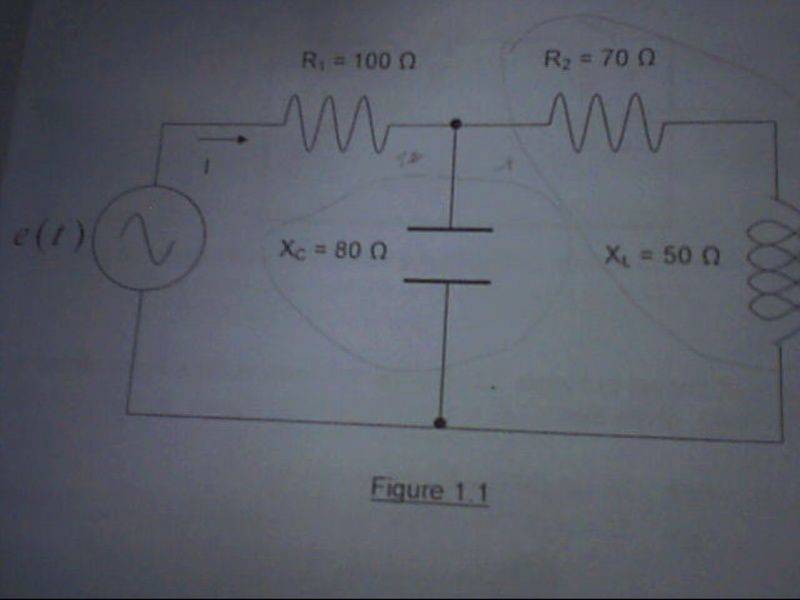

My Working for part (i); Determine the total impedance Zt:
Z1=70+j0 + 0+j50
=70+j50
= 86.023<35.537°Ω
1/Z2=1/-j80 + 1/86.023<35.537°
=j0.0125+0.0116<-35.537°
My question is do 35.537° need to be divided by 1 like 86.023? If not why?Thanks.

My Full working:
Z1=70+j0 + 0+j50
=70+j50
= 86.023<35.537°Ω
=j0.0125+0.0094-j0.00674
=0.0094-j0.00549
=0.0108<-30.28°
Z2=92.59<-30.28°
Zt= 100+92.59<-30.28°
=192.59<-30.28°
Ans is: 183.34<-14.82°
