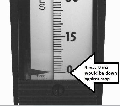

Hesch said:
That's because the device, measuring the temperature, may consume 4mA for its own internal purpose ( converting temperature to current ).
and there's added benefit of 4 to 20 ma (10 to 50 is also common)
in that an open circuit, ie detector has failed or somebody left it unconnected, announces itself as a reading well below zero.
