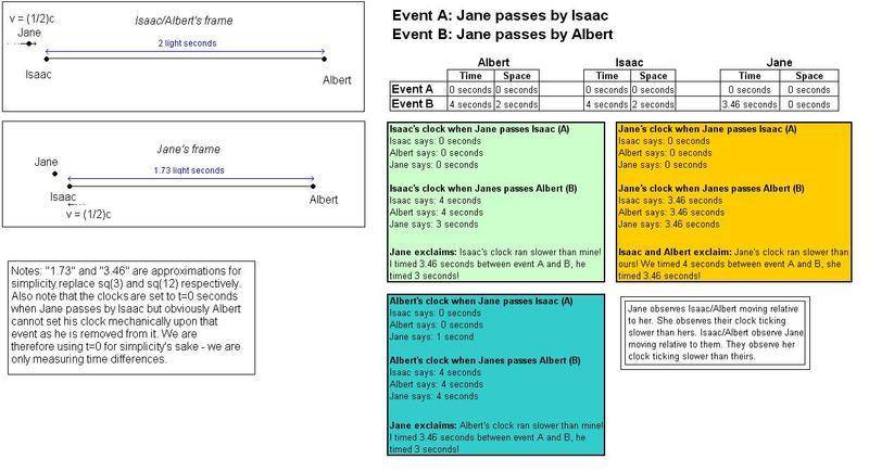

Dear all,
Following is a problem, I suppose, is related to some controversy called "Dingle's Dilemma", as I read somewhere on some relativity forum, and I wish to understand where is the catch.
Consider two inertial frames A and B, stationary with respect to each other, with two identical and synchronized clocks (one in each). Now, another inertial frame C (say a rocket) passes by A with a uniform velocity (say v). When the co-ordinates of A and C coincide while the process of passing by, C synchronizes its clock with A (and as A and B are still synchronized).
Now, by the time C reaches B (assuming that C's motion is in the line connecting A and B), for an observer in A, C's clock has been slowed down by some time (time dilation, say 1 sec), while, as there is no mechanism to establish wether A is in absolute motion or C, for an observer in C, the clock in A has been slowed down, and as clocks in A and B are already synchronized B has been slowed down as well.
What will happen, when the C reaches B? Will their clocks be still synchronized (I don't think so)! And if not, which one will be slower, B's clock or C's clock? (At the moment when B and C coincides, If the need arise, there should be some kind of accident, where, C doesn't move at all, abruptly stops, and merges with B.)

Three inertial frames A, B and C. A and B stationary while C moving with a relative velocity v with respect to A and B, and traveling in the line connecting A and B, so that it will first coincide with A and eventually B (coincide means their origins share same spatial co-ordinates x, y and z). A's clock is slightly (say 1m) away from A's spatial Origin, while, B and C's clocks are perfectly at their spatial origins. Further assume that, clocks have an intuitive mechanism, by virtue of which, they stop as soon as they are touched by anything. Now when C coincides with A, all three clocks are synchronized. Considering that A's clock was off-origin 1m, and clocks were smaller than that, the clocks of A and C won't collide, even when their origins coincide.
Eventually, C reaches B and their origins coincide, However, there are clocks at their origins, so they will collide. At the same time of collision (when the clocks have touched each other) the clocks will stop. If the clocks are intact, will there be any time difference in the time value (or rate or interval) shown by the clocks?
We should note that, As has already been posted earlier in this thread, The clocks should not collide, if their spacetime coordinates (of at least one point on their surface, where the point of impact is) are same. But, if we apply Lorentz transform on any of the clock, we will come to know that it is off-sync with the other, and hence, as it's spacetime co-ordinates are different then the other clock (time coordinate to be precise), it must not collide, yet we know it will collide.
To make it more clear, though there is no absolute time, they defined their own relative time by synchronization of their clocks, so at the time of synchronization, they were both at the origin of the time axis, yet having different spatial coordinates (x, y, z) and thus they did not collide. Similarly, if one of the observer is moving away from the other observer on time axis, even if their spatial coordinates coincide, they must not collide. This further clarifies why should their all four spacetime coordinates be same for a collision to occur. (this has also been pointed out in earlier posts)
I'm pretty sure, there is some catch in the situation, but can't see what it is, may you people help me out.

I'm sorry but you have misunderstood. I (and MeJennifer) said A and B are equivalent frames. As such you don't need A at all. In your scenario A serves only to define the time t0 that B and C's clocks have the same reading. That could be done just as easily with a light flash equidistant between B and C. B and C set their clocks when the light pulse arrives.
Any time after t0, C will observe B's clock as running slow and B will observe C's clock as running slow. This will remain true for all time unless B or C undergo an acceleration.
As for whether B and C will collide if they are at some time coincident in space, the answer is yes they will. However B and C will not agree on the time the collision occured. When the collision has occurred C will have accumulated less proper time than B because C has undergone an (rather severe) acceleration.

Now there's an interesting point. You agree A and B are equivalent frames right? That is, there's no acceleration and no relative motion between them.
So, while C will always say both A's clock and B's clock are running slow, A's clock and B's clock will always read the same time according to C. Right?
Isn't this the same as saying A and B's clocks are synchronized according to C? Or is the word 'synchronized' reserved for more specialised use?

A and B are two clocks in the same frame and are presumeably synchronized within their own frame. They are not synchronized according to frame C, since they are separated along the direction of motion. According to frame C, clock B is ahead of clock A.
When clock C passes clock A let's assume that they both read the same time (by special arrangement). According to frame A-B, at the moment that C passes A all three clocks read the same time. Frame C agrees that at the moment he passes A, clocks C and A both read the same (again, by arrangement), but does not agree that clock B reads the same time.

1. Any time after C passes A, C will see both A and B ticking slower while A and B will see C ticking slower.
2. A collision will occur.
3. B and C will not agree on the time the collision occured.
4. After collision C will have accumulated more proper time than B.
5. A was not required for any of this analysis.
Does this all seem right to you?
Sounds good.
Sounds good. Assume that clocks A & B are a distance L apart (along the direction of motion) and are synchronized and that C passes A when both read t = 0. Then when C collides with B, B will read t = L/v and C will read [itex]L/(\gamma v)[/itex].
(If I misunderstood the scenario, please correct me.)
Not sure what you mean. Proper time between what two events?
  • #32
No, you didn't misunderstand. That's exactly how I saw the scenario.
Between t=0, that is when C passed A, and when C collides with B. But I see you answered in the affirmative anyway in the previous quote.
  • #33
mitesh9 said:
the acceleration (or de-acceleration) requires collision. And without (or before) collision, there won't be any acceleration (or de-acceleration). In turn collision requires same spacetime coordinates, which as you correctly pointed out, can not happen without acceleration (or de-acceleration) within the domain of SR.
This is like running in circles...
mitesh9 said:
Three inertial frames A, B and C...
...though there is no absolute time, they defined their own relative time by synchronization of their clocks, so at the time of synchronization, they were both at the origin of the time axis, yet having different spatial coordinates (x, y, z) and thus they did not collide. Similarly, if one of the observer is moving away from the other observer on time axis, even if their spatial coordinates coincide, they must not collide. This further clarifies why should their all four spacetime coordinates be same for a collision to occur. (this has also been pointed out in earlier posts)...
Is this correct? Do we require all four spacetime coordinates equal for a collision?
  • #34
By definition, a collision means that two things are at the same place at the same time.
  • #35
But if collision occurs, whose coordinates we should consider? For event collision, the coordinates of space will naturally be same for two frames colliding, but the time coordinates of both will be different, because one is moving and other is stationary. And if both are moving, then also their time coordinates will be different. This means that two things can never collide!
