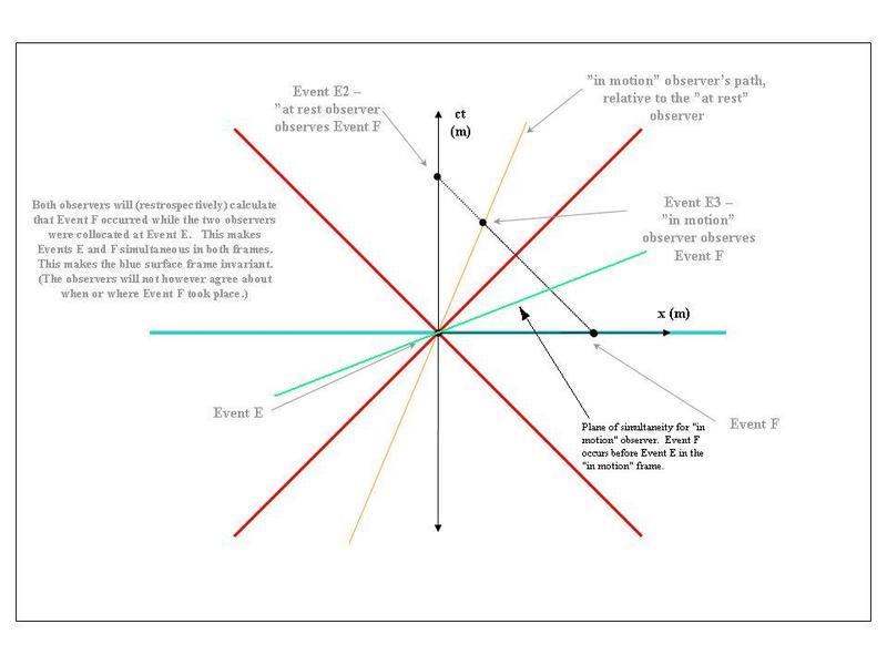

neopolitan said:
If this is the case, and I have no doubt that it is, then is there validity in conceptualising an "instant", or a "surface of simultaneity"? Such an "instant" would comprise of an "event space" in which, relative to an inertial observer (at rest in that observer's own frame), all events are simultaneous. I could pick any instant, for example the instant when I absorbed the first photon from the sun to ever hit my retina (we could argue endlessly about how long that absorption process takes and the quantum uncertainty about when precisely the photon was absorbed, but the idea is to pick an instant, so we pick an instant in which the probability that the photon has just been absorbed is maximal), and label that t=0. Relative to my rest frame, there would be an event space which was the set of events (x,y,x,0) where x, y and z are unbounded. That event space would constitute an instance or a surface of simultaneity.
All of the above is correct. An observer has, for each event, a surface of simultaneity. In special relativity (i.e. ignoring gravity) the surface is a 3-dimensional "plane" in 4-dimensional spacetime. For a single observer, all the planes of simultaneity (for different events) stack up in parallel. But, as you suggest, different observers have different planes of simultaneity. This is standard, mainstream special relativity.
neopolitan said:
Comment two: I assume that, in the rest frame of the rocket, the robots move at the same speed from the nose and tail towards the middle. This means that in the rocket frame there will be a very small amount of time dilation due to the relative motion of the robots (very small because you stipulated "gradually" as the magnitude of their velocities) and that time dilation would affect each robot and lump equally. The lumps will be simultaneous at the midpoint and will have undergone the same amount of time dilation, and, if my comment one is right, still synchonised (in the rocket's frame). Since the lumps will now be collocated, and collocation applies to all frames, I believe that they will then be synchonised in all frames.
If I understand you correctly, you are claiming that, if two separated clocks on the rocket are synchronised according to an outside observer, when you slowly move the clocks together they should remain synchronised according to that same observer.
This may seem reasonable on the grounds that both clocks undergo the same time dilation. This would be true relative to the rocket, but it's not true relative to the outside observer; from the observer's point of view, one clock experiences more dilation than the rocket and the other less.
You might then argue that any change of dilation can be ignored if the clocks move slowly enough. However, this ignores the fact that the slower the clocks move (relative to the rocket), the longer it will take to bring them together. This lengthening of time taken increases the effect of the dilation. In fact the decrease in dilation-change and increase in duration tend to cancel each other out, and no matter how slow the clocks are moved, the there is a change between the clocks that will not go away, relative to the outside observer.
If you really wanted I could prove all this mathematically, but it would take a page or two of calculation.
Note that synchronising clocks by slowly moving them apart is referred in the literature as "slow clock transport" or "ultra slow clock transport". It can be proved that synchronisation by slow clock transport is exactly the same as Einstein synchronisation. For example, see this post.

neopolitan said:
What I was trying to say is that, within the rocket's frame, the clocks that are at first synchronous, at rest and separated, will in the scenario presented arrive at the midpoint having undergone the same amount of time dilation - within rocket's frame - and therefore be synchronous, at rest and collocated.
You started out this thread stating you wanted to stick to one observer (Let's call him Fred) to avoid confusion. Fred is an observer that is not onboard the rocket but was at one point at rest with rocket before the rocket accelerated. I have inserted red text in square brakets to make clear which measurements are Fred's observations. Consciously or unconsiously you now talking in terms of another observer (call him Barney?) who's observations I have inserted in square brakets and blue text in your statements.
"What I was trying to say is that, within the rocket's frame [Barney's frame], the clocks that are at first synchronous [According to the observer onboard the rocket], at rest and separated, will in the scenario presented arrive at the midpoint having undergone the same amount of time dilation [As measured by Barney] - within rocket's frame - and therefore be synchronous, at rest and collocated."
