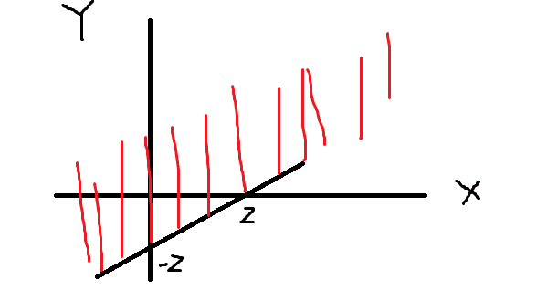

Z = X - Y and I'm trying to find the PDF of Z.
Convolution
Started by finding the CDF:
Fz(z) = P(Z ≤ z)
P(X - Y ≤ z)
So I drew a picture
So then should Fz(z) be:
since, from my graph, it looks as though Y can go from negative infinity to positive infinity, and X can go from negative infinity on the left but is bounded by z+y on the right
then should the pdf be:
Edit: sorry I forgot to include the fact that, because fx and fy are independent, f(x,y) = fxfy in the following derivation

Your approach looks reasonable. Is there something you are particularly worried about?
Oh yes, sorry I was wondering if what I arrived at for the PDF of the difference of two independent random variables was correct.
I tried Googling but all I could find was the pdf of the sum of two RVs, which I know how to do already.
Yes, it looks ok. You should note that if you know the pdf of the sum and the pdf of the negative of a distribution (i.e., if you know how the the distribution of ##Y##, what is the distribution of ##-Y##), then you can use these two to obtain the distribution of ##X-Y##.

You already drew part of the diagram in Post #1. You just need to add the boundary lines x = 0, x = 1, y = 0, y = 1 and you are done---that's your drawing!
