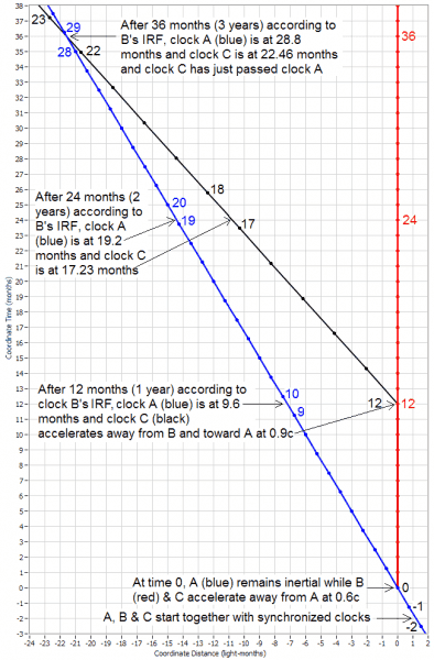

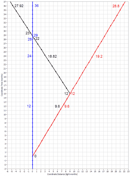

  • #34
Taragond said:
Hi ghwellsjr,
sorry for my long absence!
I'm really struggling with making the time for this, and having still enough plasticity of mind to at least think I might understand ;)
What I think to have found out...most of my general problems (besides mathematics, obviously) with this seem to have originated in my failure to understand why I would "see" light always as moving with c...
Of course, if I'm moving faster I percieve time as I do when standing still...so anything theoretically moving slower compared to me than to the still observer (from his perspective) would seem faster to me (from my "slowed down" perspective)...don't ask me how I could overlook that, I have NO IDEA :D
It's really easy to overlook things that are going on with relativity. The only safe thing to do is precisely specify whatever scenario you are interested in according to an Inertial Reference Frame (IRF) and then use the Lorentz Transformation process to see what it looks like in another IRF. So let's do that with what I think you are describing here although since you weren't very precise, I may not be addressing your issue.
I'm assuming that you have started with the IRF of the "still observer" and you are traveling at some high rate of speed (0.8c) while some other thing is traveling slower than you (0.5c), correct? I'll show the still observer in blue, you are in green and that other thing is in red:
Now you have concluded that since your time is dilated in this frame, you will perceive that the time for that other object will be faster than your time according to your rest frame, correct? Well let's transform to your rest frame and see what happens:
As you can see, the time for that other thing as shown by the spacing of the red dots is dilated even in your rest frame. Does this make sense to you? Or did I misunderstand your scenario?
