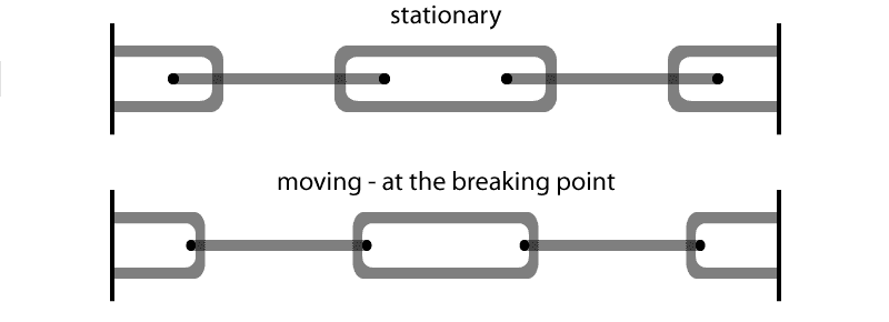

A.T. : You wish to apply a different rule to the separation of the two hooks that hold the string ends than you would apply to the same string ends.
I have no idea what you mean.
1) The distance between the hooks and the length of the string is the same, unless the string breaks. That distance is given to stay constant as measured in the inertial frame. That's simply the scenario, I'm not applying any rules here yet.
2) SRT says that the atoms of the string will contract as they accelerate. Here I apply SRT.
Thus, at some point those contracted atoms cannot fill the still unchanged distance anymore. The string breaks.

If contracting atoms are too abstract, then replace the string with a chain. The accelerating chain links will get shorter and shorter, so at some point they cannot span the constant separation distance, and the chain breaks somwhere.

In S', the ships do not accelerate the same way, and the distance between the two is increasing. Since the front ship begins accelerating first, I'd imagine that the string has to slip from the front ship's sheath. This agrees with the fact that (I'm assuming the sheaths to be frictionless) since the ships accelerate forwards the string would slip backwards in the sheaths.
  • #59
DaleSpam:
It must surely also follow that if it doesn't break in one frame then it doesn't break in all frames ;-)
The main point of frame invariance is that if you can show that it breaks in one frame then you should be able to show that it breaks in other frames.
  • #60
schaefera:
Please tell me why you think "...that the atoms themselves are shrunk, but not the space they are in."
