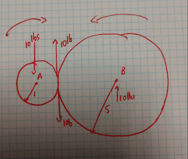

Gear A DRIVES Gear B right?
There are contact forces between the two yes? Equal and opposite.
I see a torque arm of 5 inches, with a force of 10 lbs acting on gear B about its center. If there is a N3L for torque, i am trying to understand where does one account for this?
If i take all the torques about the center of gear A, i can see how angular momentum balances, but still Gear B has a torque applied to it, and i don't see where its equal and opposite is?
Perhaps someone ccould sketch on paper and show me what i am missing to help with all the 'about this or that"
  • #67

Okay, I took all the torques about center of gear A, and I agree and got the following as @AT instructed. Note*** I assume that gear B is connected to a shaft mounted to the ground which wasn't shown in my sketch.
When taken around the same point A: torque_by_MOTOR_on_A = -torque_by_A_on_MOTOR
torque_by_B_on_A = -torque_by_A_on_B
torque_by_GROUND_on_B = -torque_by_B_on_GROUND
Then all agree with N3L. But then if I break down the system more, and look specifically at gear B, I see it has a torque about its axis which is why it rotates. Plus this is the reason why angular momentum balances between the earth/gears as a system. When you calc Ang momentum of the system around A, you see equal but opposite values. Gear B about point A has Ang. Momentum opposite of the Earth portion about A.. And it has to balance as @Dale said.
Sorry took me so long to see it. I realized I was confusing systems and torques by analyzing different points at once

Okay, so i have tried to let this sink in and now i know better what I am asking.
Imagine a plate, that has a motor connected to gear A and gear A is driving gear B. Gear B is also connected to plate. Disregard friction. Rotations are as show.
Now when the motor starts up, it put in 10inch-pounds. Let's say all the power goes to Gear B to make it spin( i know there would be alittle to gear A but i am ignoring it)
Wouldn't for ang mometum to be conserved, the entire system/plate have to rotate CW, which is opposite of CCW gear B?
Therefore if I take the sum of the torques about center of gear A, shouldn't i get the torque that makes system about A spin? I am not getting it. For some reason they cancel out.
I know the contact forces at the gears provide no net torque on the system about A. But if the gear B applies a force to the axle of 10lbs, and the axle provides 10 lbs back, those torques cancel. So what am i doing wrong
  • #74
Your description of this new system is kind of a mess, and I don't think it's physically possible as described. A couple of things:
  1. 10 lb is a force, not a torque.
  2. If an object spins at constant speed, the net torque on it is zero. For what you described, the torques don't appear to sum to zero. I don't want to tell you how to design your own system, but it looks to me like object B needs a brake.
  • #75
